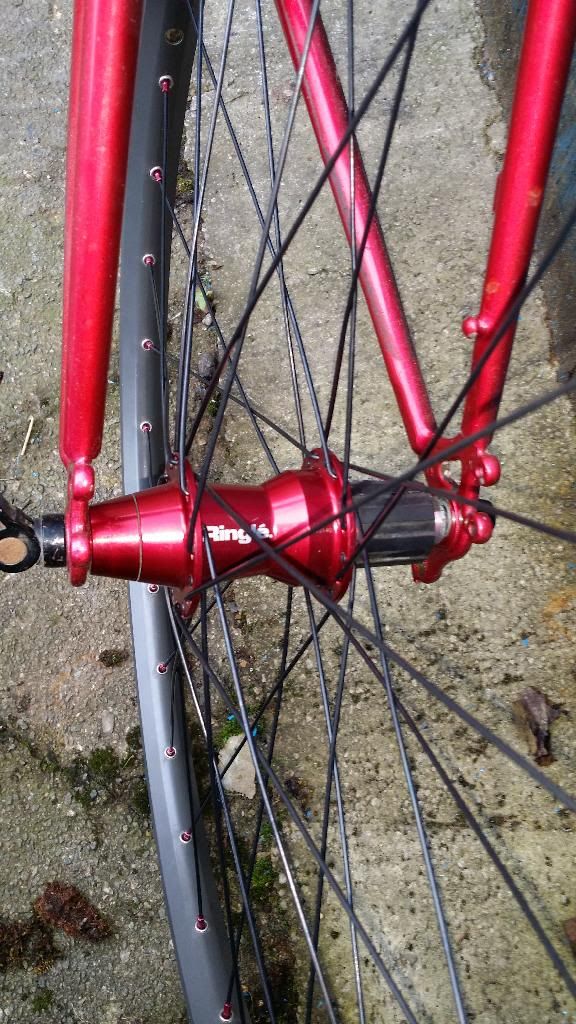

Ringle hub i.d which one is it
paul6693
Devout Dirtbag
hi all I know it's a Ringle bubba but is it a super dubba flubber or a rubba dub chubba and will it take a 9 speed cassette as I don't have one to try.......many thanks...
fattiman":16w73ump said:
Super duper 8
thanks for that I had a feeling it might be I've looked at lots of pictures just need to know if it will take a 9 speed but with the name super duper 8 I won't be holding my breath :mrgreen:
I think I'm right in saying that 8, 9 and 10 speed cassettes/freehub bodies are all the same width and interchangeable.
Might be wrong though, so perhaps someone else can confirm or deny that.

Yup. I have examples of these hubs on 7,8,9 and 10.
Just need a spacer from an old cassette, or indeed an old sprocket will do, to run it with 7.

that's great thanks to all.... :mrgreen:
