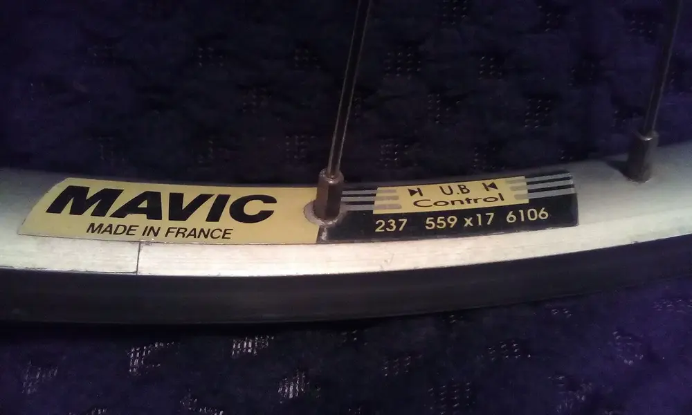

The Mavic 237 UB control Rims Are 559x 17
I have a 32 hole rim in silver on Ebay
Its built up as a Front wheel . If you get stuck pm me :xmas-wink:
