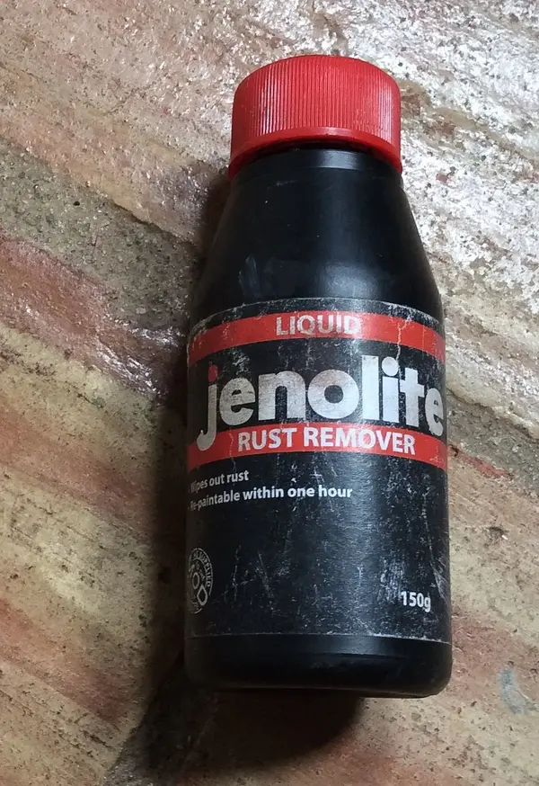

Use genolite for steel parts, make sure you get the gel version as it's less messy, apply, wait an hour or so, wash off with water, mad I know, Rust is converted to metal. Doesn't affect aluminium.
If you use the gel version you can easily wipe excess off with a cloth, this stuff isn't an acid, I usually get some on surrounding paintwork and tend to wipe it off with a damp cloth before it dries ( it takes about an hour to dry) but it has never left a residue on the painted area.
