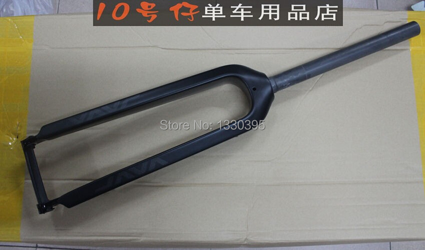

Also depends what it light.. The Merida forks I have (there's a similar set on sale here)
feel light at about 760g, but in reality are quite an average weight. The others I have are much higher a2c (485mm) so will fit a 650b wheel, yet weigh only 570g, so...
These are commonly sold with Java branding on:
Full-100-carbon-fiber-26er-27-5er-JAVA-hard-fork-for-JAVA-MTB-Bike-Compatible-Black.jpg
Things to take care of are 1) the sfn, to ensure that as you tighten up the headset you're not pulling the sfn up the steerer tube, as sometimes they can slide up inside the steerer. 2) Don't hit or push down on the steerer if the dropouts are on a hard surface as you don't want to damage them. 3) Take care, even use a bit of light grease, when fitting spacers and stem if the steerer has been cut. You can delaminate and strip the steerer if you get these angled wrongly, like stripping bark off a tree, so make sure everything's lined up right. Remove the grease after fitting though! Also best if you can to use a 2-bolt stem and I always avoid using stems which don't wrap fully round the steerer i.e those without material filling in the gap between the clamps. Probably more psychological than anything!

It is the...ummmm....Merida ones off here..... :oops: :oops:
So looks like they should be safe then! This is what happens when modern technology is allowed into my life, turns out they're actually quite heavy for a carbon fork.... :lol:
