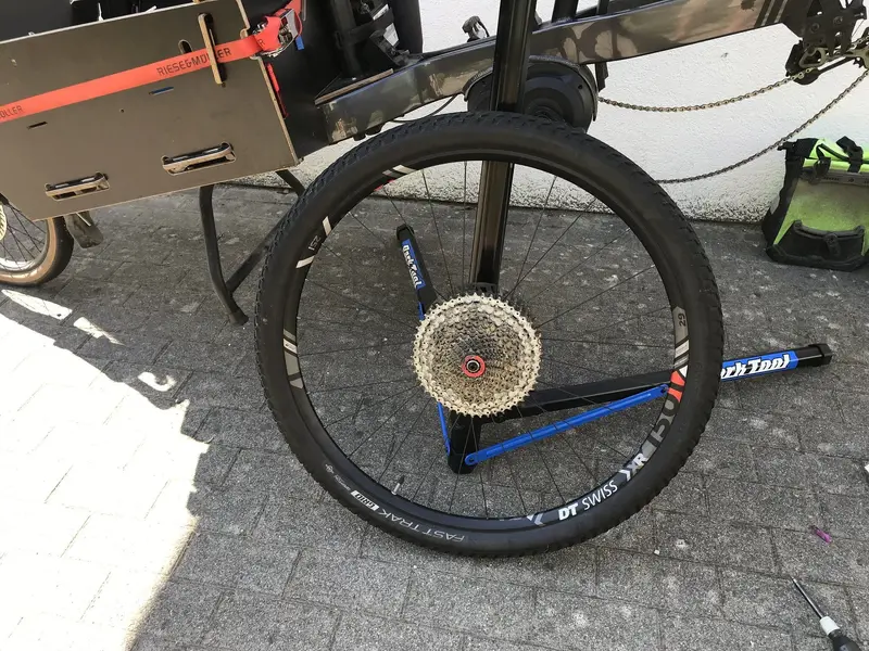

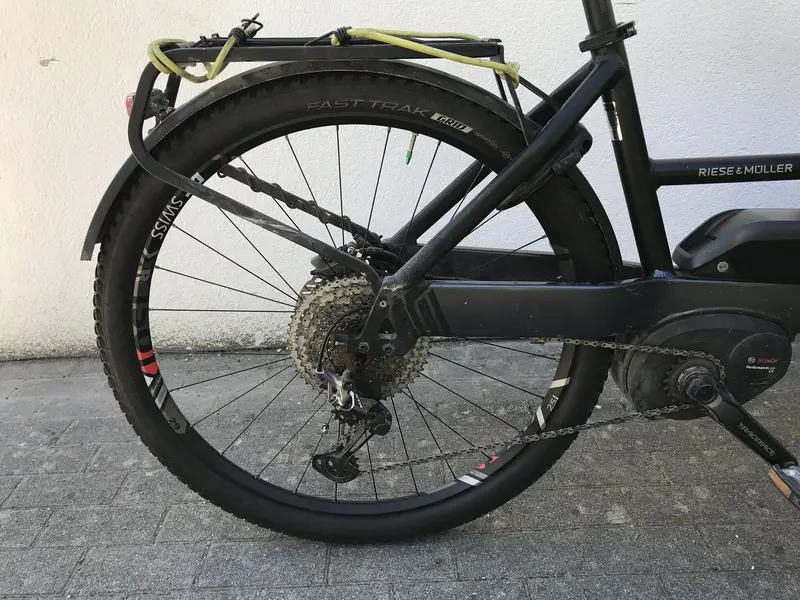

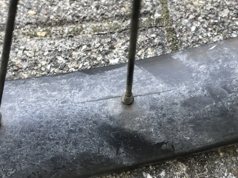

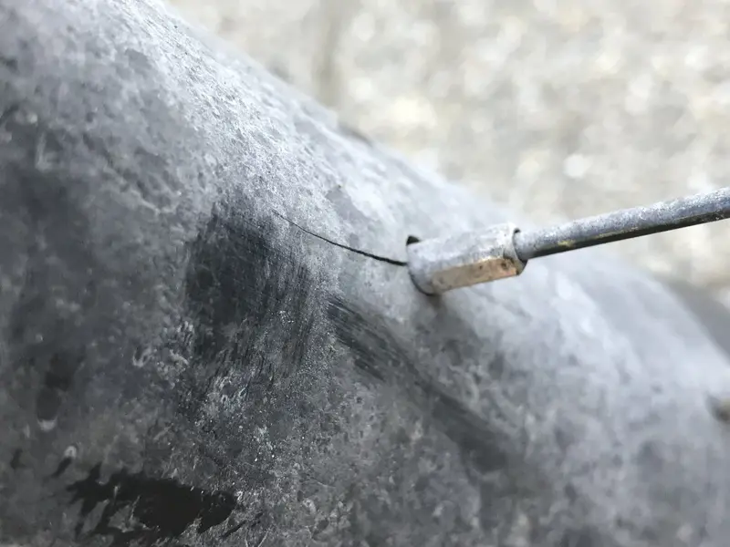

The original Alex rear rim was cracking at the spoke nipples in several places. Planned on building wheels on Hope Pro 4 hubs but never got myself in gear to get all the parts together. This 29” wheel came up for sale locally. Shoe horned in this 29” where the original was 27.5”. Total rolling circumference increased by 20-25 mm or so.

Edit: BTW, how much torque did you put on that cassette lockring on your new 240 rear hub?
I'd be worried of the freehub splines getting damaged running it in conjunction with a motor.
That cassette does not look like it's machined out of one piece. So if the lockring is not sufficiently torqued the individual sprockets might try to eat their way in to the freehub splines.
Had that happen on both DT and Hope hubs just with leg power...
