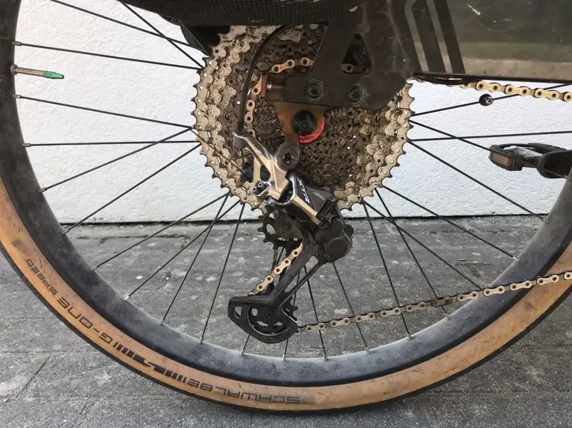

This is my family hauler, grocery shopper and bike frame deliverer. For going to the city center my wife sits in the front box and the kids attached to a Thule trailer on the rear. Put over 15,000 km on this. Been through one motor, 15 chains or so, one fork rebuild, two cassettes, two deraileurs, two shifters, three calipers, two sets of rotors, four sets of pads, two front cogs/chainrings, two sets of grips, maybe 20 tubes even though I am using Tuffy's and other puncture resistant wizzardry. She's a heavy beast at 55 kg (with the battery) as she sits here.

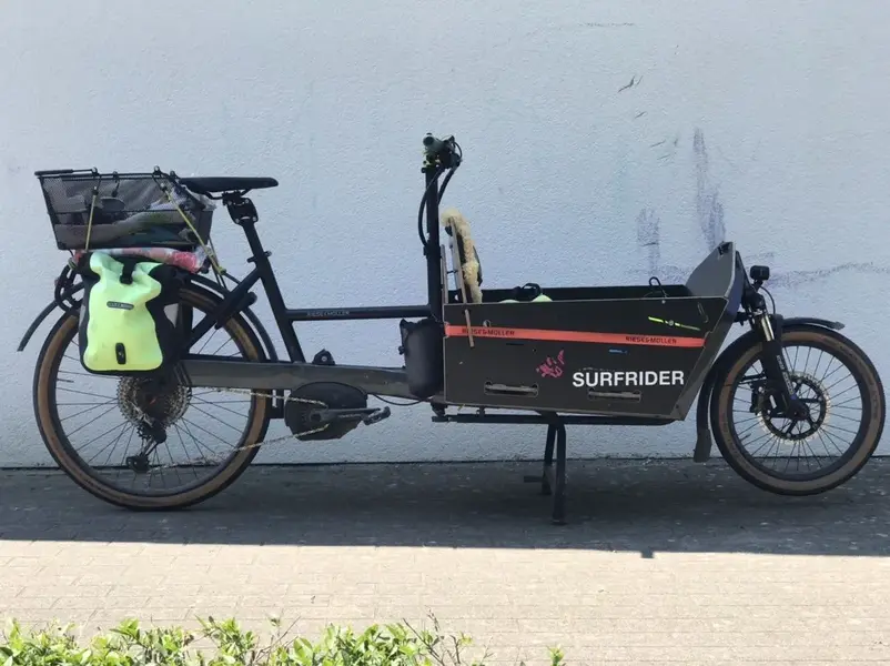

The girlfriend and I got an E-Bullitt last year to haul around the kids and try to escape most of the chaotic traffic in town.
I'm pretty happy with the bike and the parts it came with (pedals and seat were changed immediately, though).
We opted for a 5s Shimano Nexus Di2 hub, belt drive and the E6100 motor.

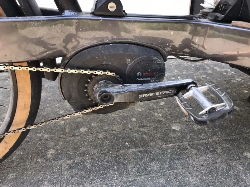

The first motor died at about 1.500km. I could not find much info on the web, but the problem might have been a fairly large plastic cog that synchronizes the pedal and motor power onto the shaft that in the ende drives the belt.
Searching for other users problems, what came closest was the 'E8000 duck noise'.
The motor got replaced under warranty and soon started to produce the same noise again. Although it seemed like it tried to adjust itself several times. Until the noise stopped completely and did not return for the last 6-700km.

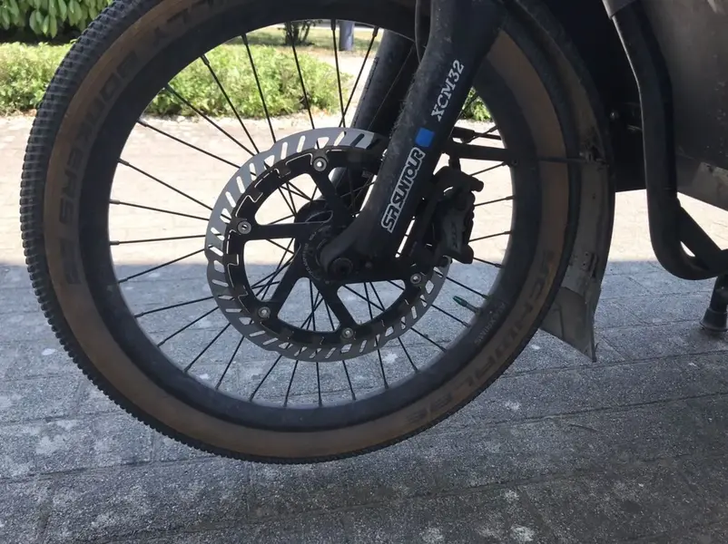

I like the brakes it came with. TRP Slate E-MTB 4pots. Decent stopping power and easy to change pads.

Initially we thought about getting an R&M Load, as you can order it with a footwell for the kids. But you need to buy a third seat to have that option. Quite unreasonable, imho.
So, now owning a Bullitt without a footwell, I made one myself. With the help of my then 2yo son.
I made a couple mistakes and we gained not a lot of room, but it was good fun!

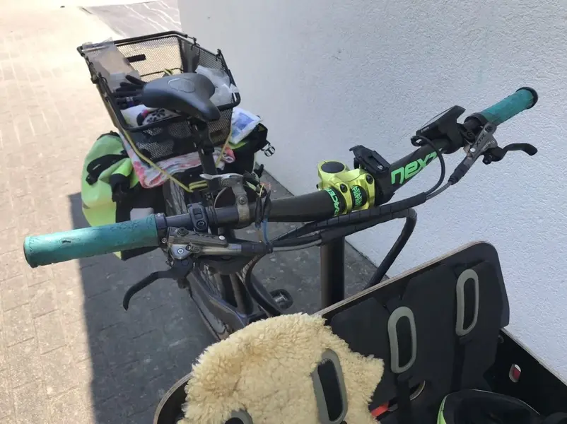

p.s. The bike developed some quite severe steering wobble, if you exceed 40km/h. Does not happen too often, but it at least feels very dangerous.
So I am checking options on fitting a steering damper in the near future.
