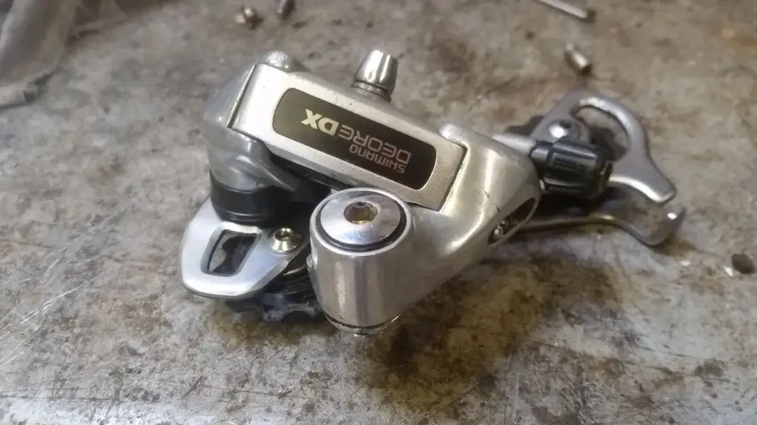

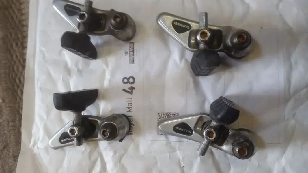

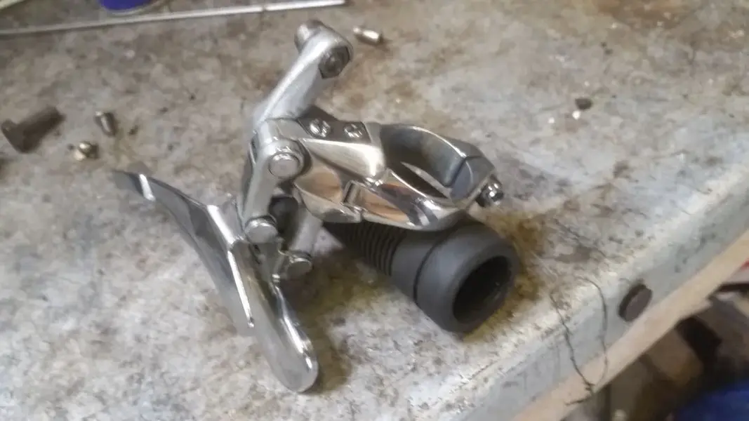

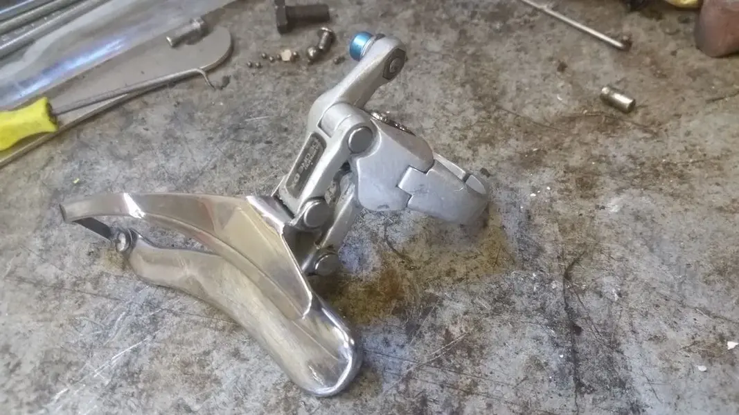

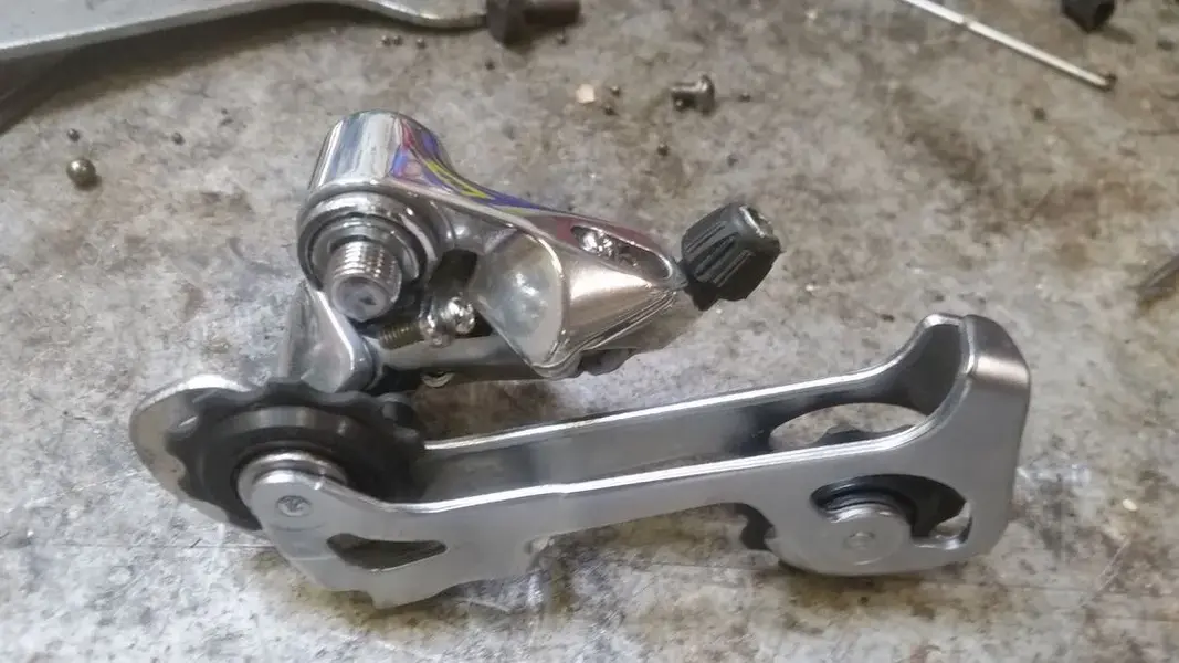

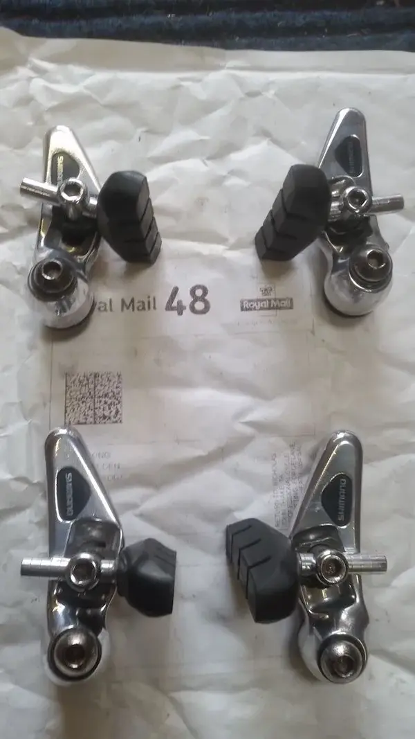

So the nice postman turned up with my brakes today :) but no sign of the shifters :( so I thought I'd get on with some polishing :D
Also did the mechs too :)

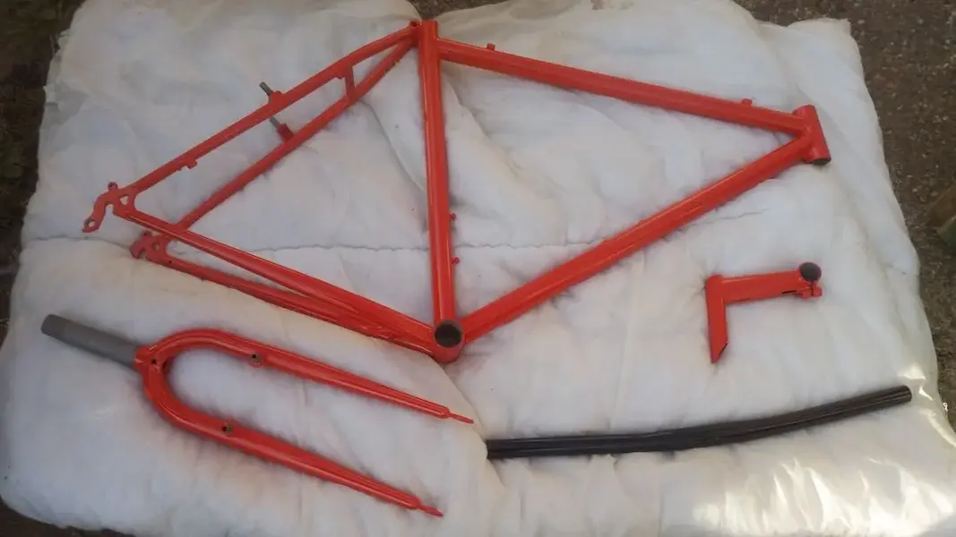

Got a call from the powder coaters around midday I was over there in a flash :D The finish isn't masterclass level but it is IMO good enough and I'm fairly happy with it I doubt that the colour is spot on either but going by the catalogue scan its not a million miles off.
been on the net and have sourced myself a headset and a set of cranks now just looking for wheels and waiting for the shifters to arrive :D
I've also been in contact with Gil_M about the transfers and as soon as he returns to work we can get the ball rolling on those

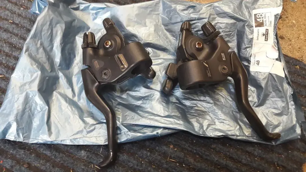

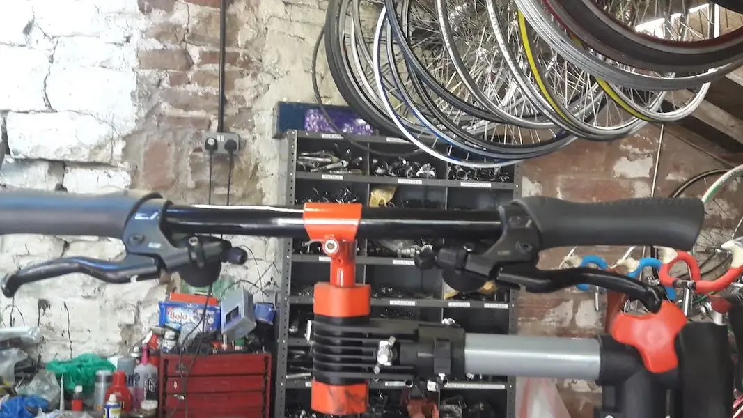

Yay shifters arrived this morning, I couldn't help myself and so assembled the cockpit :)
The RH shifter triggers miss the grip whilst the LH one catches just slightly so I'll have a fettle to sort that out.

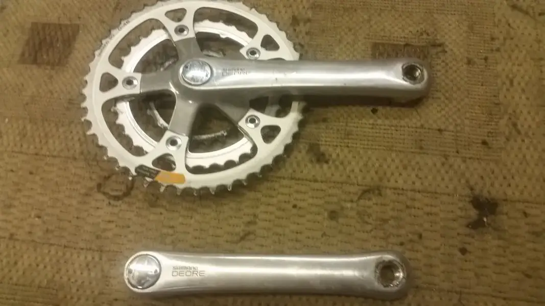

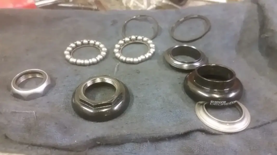

More parts have arrived this week namely the headset and chainset :)
The cranks need a polish and I also need to take the forks to a machine shop and have the steerer crown turned down by 0.5mm so I can fit the crown race :? . It's never straight forward is it :roll:
