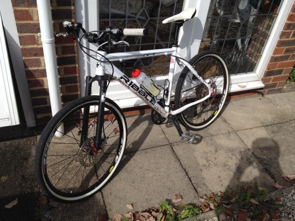

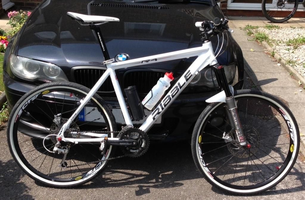

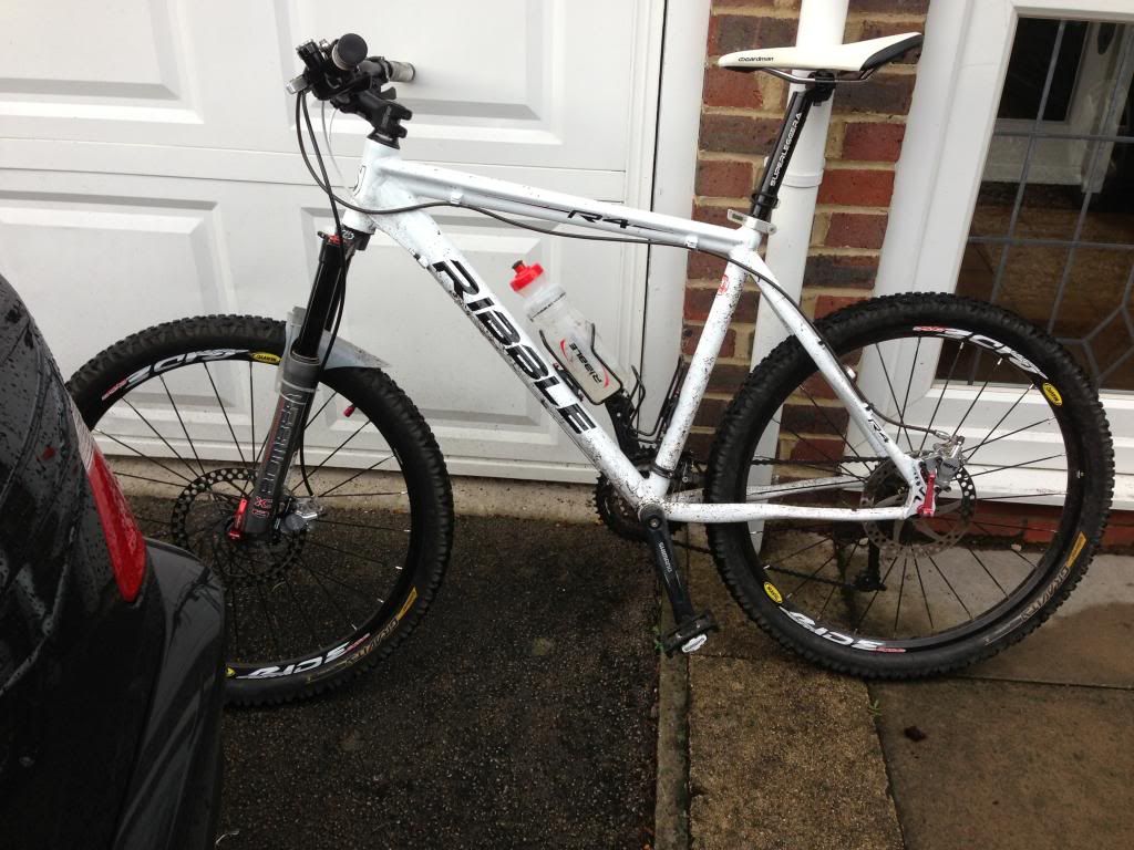

Wee update,
This is how the bike stands at the moment:
Changes since the last pictures include:
Mavic Cross ride wheels
Shimano XT shifters
Shimano Deore M592 Shadow 9 Speed Rear Mech
Marzocchi XC 600 2007 Forks
Boardman black and white seat
oh and the white wall slick tyres are back on (old pic):)
