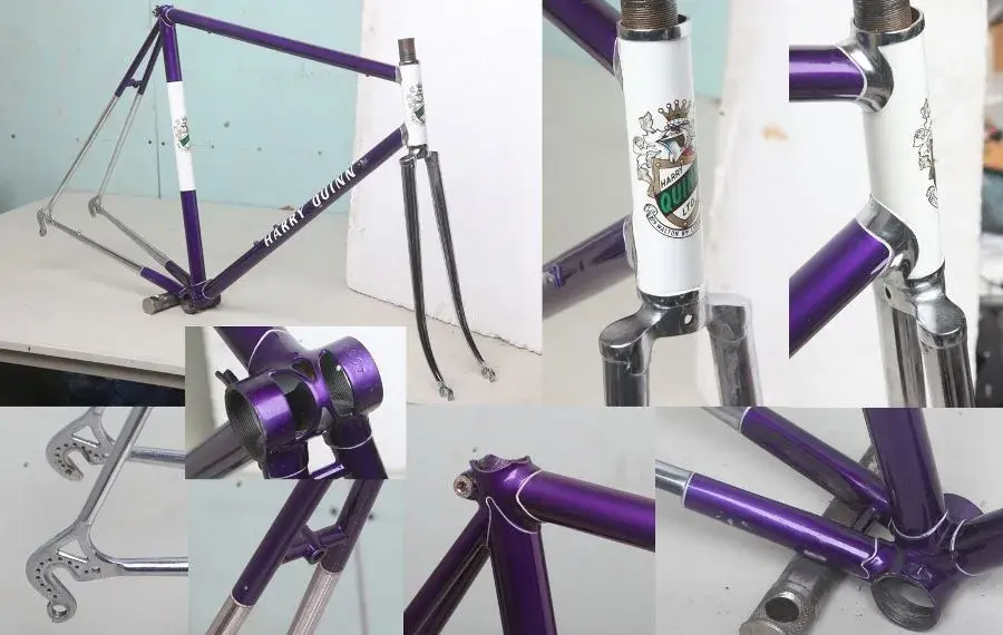

My Quinn frame (below; pic courtesy of Hilary Stone) is a 54cm and weighs only 1585g bare!
HW
What tubing is this? That is light, but there's not much left of that bottom bracket.
The link shows a 2400 gram tube set (501) as superlight! Ha!
Would be nice to know what the current tube sets weigh. Especially 831 and 931.

I should have included this in the original post :facepalm: Hilary believes the tubing for my Quinn is an extralight 531 variant that Reynolds had available at the time, but which were non standard (might this have eventually become 531SL?) Bear in mind this is a 60s frame...

That HQ is extremely light compared to 531SL (mine was 2500g) so either Reynolds thinned the tubes down so far it had no strength or it's something else entirely. Is that the frame and forks weight or just the frame?
