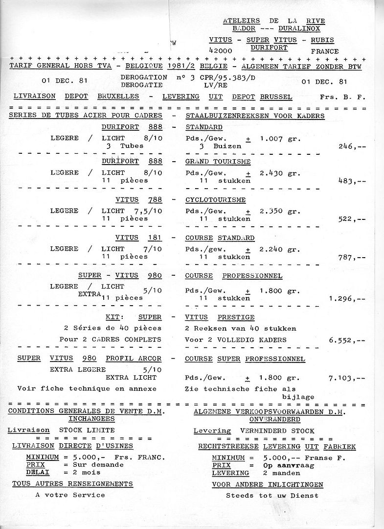

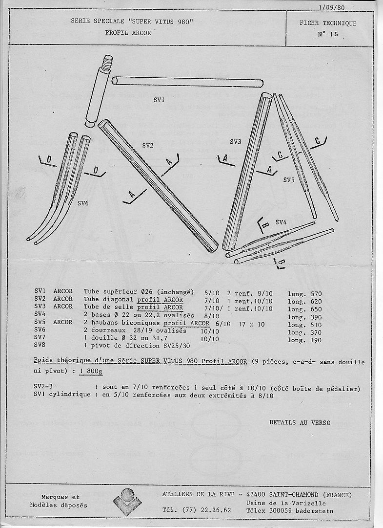

Well think Vitus and Excell from France should be mentionned here :mrgreen:
Vitus produced by the Ateliers de la Rive
Super Vitus 971 in 6/10 and 980 in 5/10 possibly comparable to Columbus SL an EL or reynolds 531 SL
Pretty original too , the vitus oval shaped Vitus 980 in 5/10 named Arcor - very rare and very light 8)

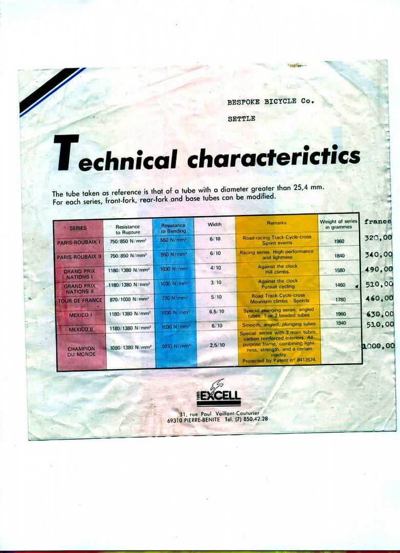

and very upmarket and rare the tubing Excell one which lasted only from 87 till 98
which produced even some 3/10, 4/10, 5/10, 6/10 tubing and very special 2.5/10 tubing with steel and carbon 8)
Here is a bit of period docs with weight mentions :idea:
We start with reynolds and follow with the french likes :wink:
