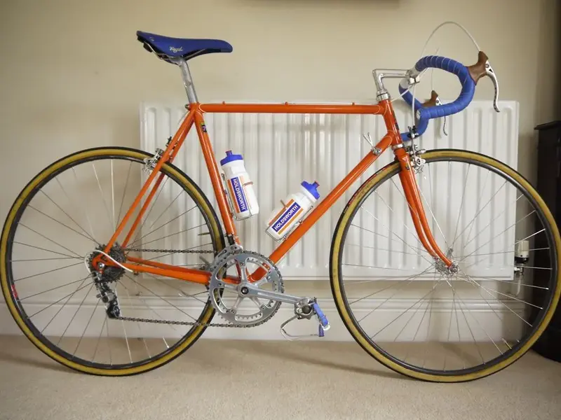

Completed:

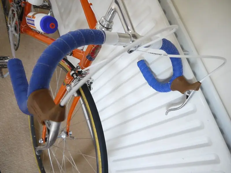

Jagwire brake and gear cabling fitted, brakes adjusted. Simplex friction levers tightened.
Handlebars wrapped in perforoated leather look tape
NOS Mavic front and rear derailleurs fitted and tuned (very straightforward). Used a Super Record rear derailleur outer cable as Jagwire too rigid.

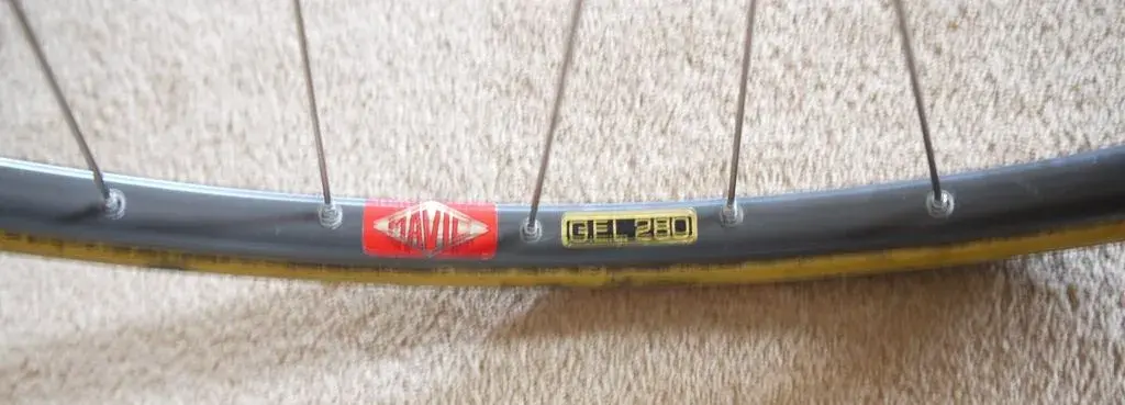

Swapped wheels to Mavic Gel 280 tubulars (32 spoke) on Super Record hubs:running 25mm Vittoria Corsa SC tubulars....a different look from the Nisi chromed rims. Freewheel is an Extraleggeri Everest alloy 15-28.
Road test to follow....
