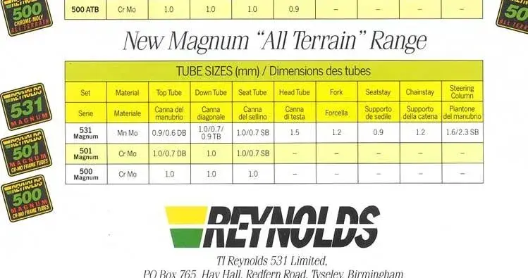

OK, here's the tube spec for your old 531 Magnum.
So:
Down tube 35mm 1.0/0.7/0.9mm butting
Top Tube 31.8mm 0.9/0.6/0.9mm butting
Seat tube 31.8mm 1.0/0.7mm single butt
Chainstays 30/17 oval 1.2mm wall
Seat stays 19/14mm double taper 0.9mm wall
If you wanted another steel frame with the same characteristics, the actual steel alloy used is irrelevant, as all steels have the same unit stiffness...the same stiffness for any given volume of material.
What dictates the feel (aside from the geometry) is the stiffness (or not) produced by varying the tube diameters, tube shapes, wall thicknesses, and the lengths of the butting.
With higher strength steel alloys, stiffness is gained by further increasing the tube diameter, but reducing the wall thickness to keep the frame weight low. With a higher yield strength, the stronger materials can flex/strain more without bucking.
Generally, named butted steel tube sets for custom builders are pretty high end and high strength these days.
Most named bike tube manufacturers do not have much tubing with wall thichnesses like old 531 Magnum these days, since their steel alloys are so much stronger.

I think it's important to note that the Magnum range (including 531, 501 and 500) were all very overbuilt, presumably as a response to the lack of knowledge at the time on just how much load a mountain bike frame could be expected to receive.
531 was a very good and long established steel alloy, up with any of the 4130 Cr-Mo materials that are still available.
More experience of mountain bikes builds combined with later higher strength alloys, steel mountain bike tubing has changed a lot.
If you look at the rest of the Reynolds chart at the time, you will see that most of the 531 variants have the same wall thickness as Magnum but are smaller diameter...
Stiffness increases proportionally with wall thickness, but increases as a cube of the diameter, so adding 1/8" to the diameter of a 1" top tube, while keeping the wall thickness the same, adds 12.5% to the weight, but 42% to the stiffness. Sometimes that much stiffness is not a good idea.
