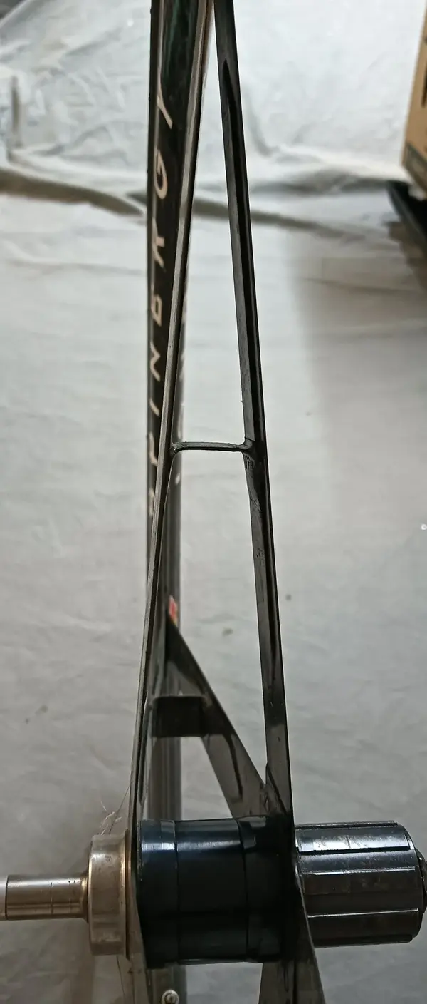

Hello, does anyone know how the spinergy rev x wheel stiffeners are fitted? Is it glued into place between the spokes?
Thanks
Yes ,the X Beams had double sided tape on them and fitted about midway between each pair of spokes
I couldn't find any X Beams when I recently bought a set of used wheels so I made my own carbon ones (my old career, now retired)
Oh that's cools. Iv just got some rev x's repaired and have seen that I can get some x beams 3d printed.
Double sided tape it is then, thanks 👍
I saw a picture of some 3D printed ones and they were terrible imo , which is why I laminated my own

I did it for stiffness more than safety , but it must also make them safer I assume
