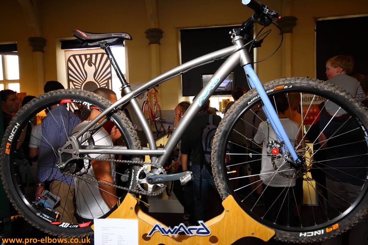

I came across this fat-bike E-stay being built by Whit Johnson at Meriweather Cycles:

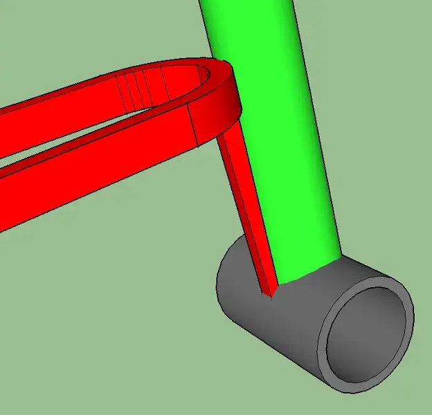

I have long thought that they should be due for a return, specially in fat bikes, where tyre and crank/chainstay clearance is such a problem.
Combining smaller front chainrings, double or even single chainsets, fatter seat tubes and low mount front derailleurs is should be possible to overcome a lot of the problems we had before, and gain back the short chainstays and good mud clearance.
Any views? Any other new build e-stays, particularly not fat bikes?
