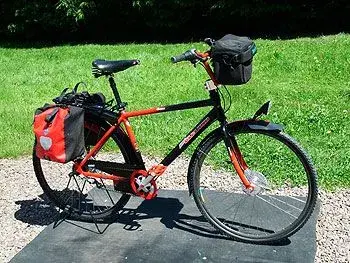

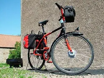

Tell me about it. I love cycling, but I hate the way the industry wants me to emulate racers! Why should I have a machine that needs to be tuned after every ride?
I think my current steed is moving in the right direction; it's going to be reborn with all the mechanicals inside sealed units in the future as time and funds allow. For many years my thoughts on bikes were leaning towards a lot of ideas that are on your Cleland, but apart from a tiny reference to the Range Rider in Richard's Bicycle Book, I'm ashamed to say I'd never heard of them until I came here. Here's what my bike looks like now:
Still a bit too racerish, and it doesn't have the mud clearance. But watch this space. :wink:
