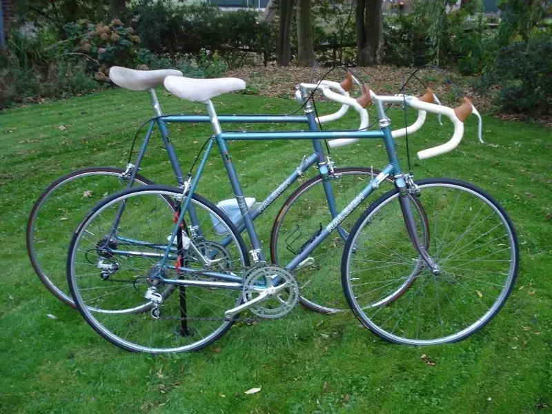

The Raleigh I know of that came in "iridescent green" is the 1984 Competition 12, one of the prettiest Raleighs ever, IMO.
This is the (lousy backlit) 1984 catalogue picture:
In reality the color leans more towards blue:
If "your" bike of one of these, I would not hesitate to update the frame by removing unwanted braze-ons. They are not that rare.
If "your" bike of one of these, I would hesitate to update the frame by removing unwanted braze-ons. They are not that rare.

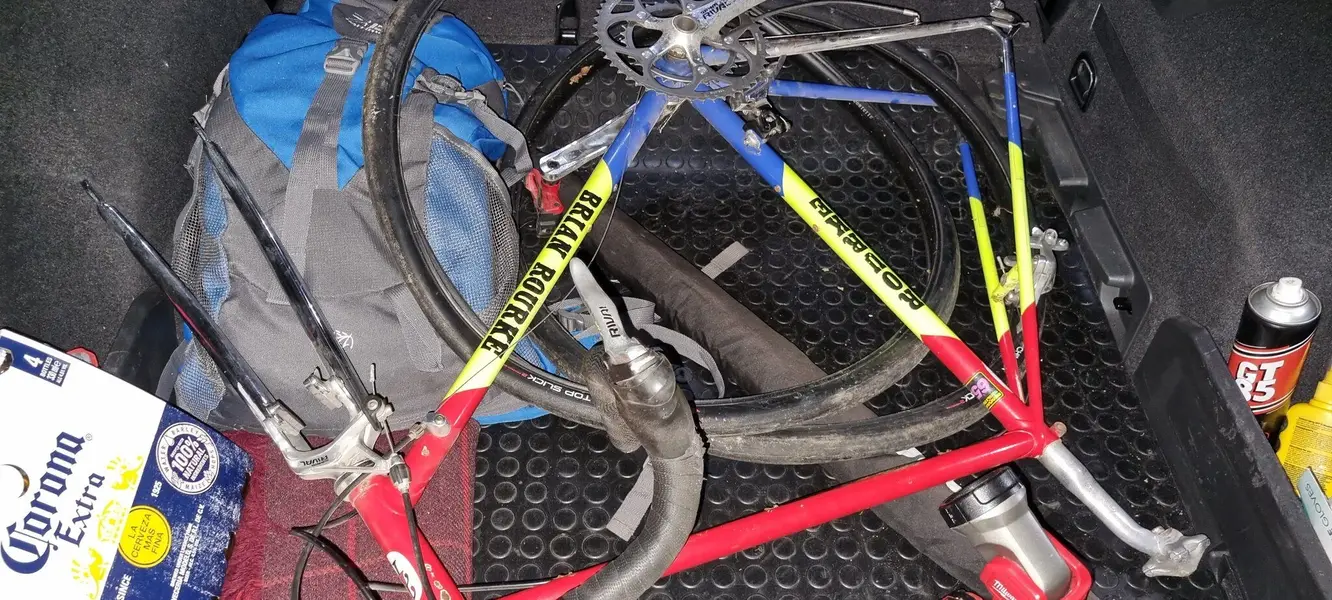

So I came across this tonight... couldn't resist for £20.00 on marketplace... looks BIG but I used to go in the Rourke shop in Stoke a lot about a decade ago, its got some war wounds and no doubt a Campag seatpost that wont be fun to remove but i'm keen to properly ID it and get it cleaned up :)

Abandoned the Rourke as its too far gone :(

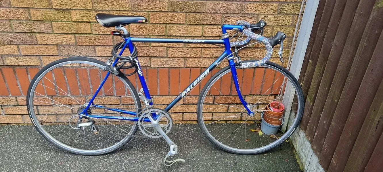

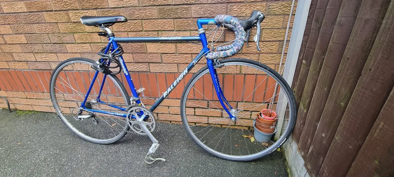

Here is the donor bike, nothing like he described haha. Trying to age it, I think mid 90s between dyna and mtrax eras. Shimano 600 groupset & super clean!

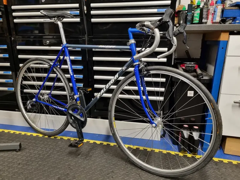

For anyone interested I've now pretty much nailed this build...

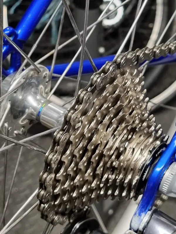

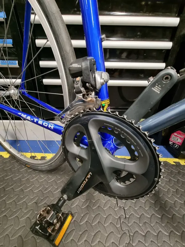

Bike is dated as 1995 - it came to me completely stock and has a 1995 molding mark on the underside of the saddle, its a hybrid between the Dyna and M-Trax eras, hence Dyna decals and M-Trax paintwork (as featured on some of the Tour De France bikes that year). I've removed the entire Ultegra 600 drivetrain and brakes, replaced with Ultegra 6870 Di2 setup (R8000 chainset) 50/34 and 11-28 11spd.
I ended up having 1.7mm machined off of the inboard of the cassette to get it to fit on the stock 34.9mm Shimano 600 freehub - r.mech awfully close to the spokes on lowest gear so i'll look to put a very small spacer (1mm max) between freehub and hub to aid this (still need to experiment).
Di2 wiring straight through headtube badge allignment pin hole in headtube, neatly opened upto 3mm, all internally and then out the chainstay dropout breather hole - had to chop/splice/solder/heatshrink the cable ends but not overly difficult.
28mm Conti Grandsports might be swapped up for tubeless tanwall Vittoria Corsas that I have spare - might even attempt a tubeless setup with them.
Really happy with how its all turned out.
