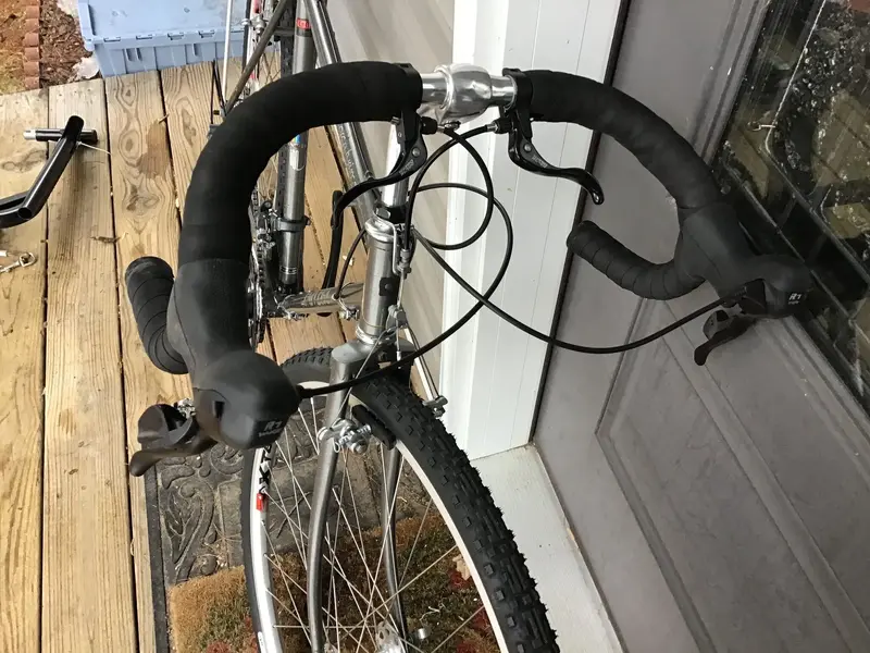

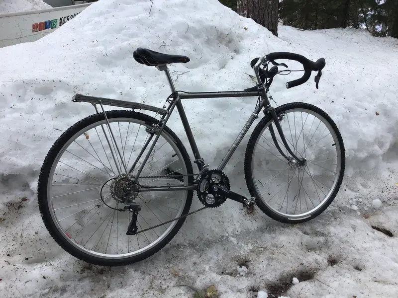

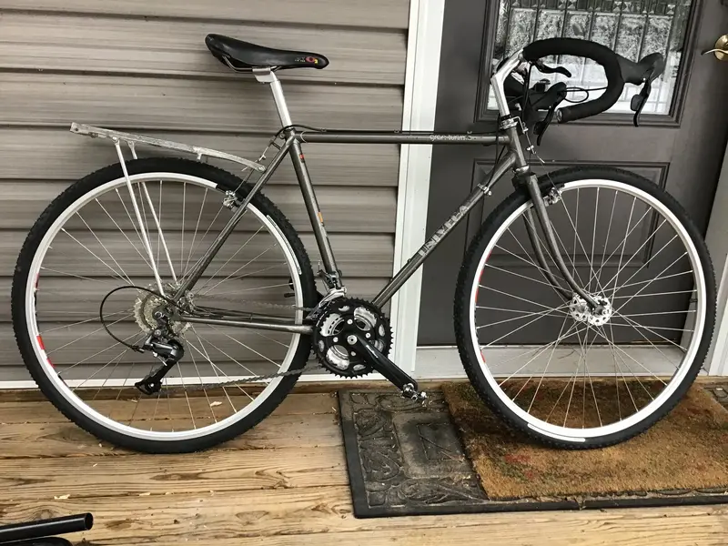

Four years ago I got a vintage Japanese touring frame and fork. No double butting as I wanted the bike to weigh close to 80 pounds loaded. I used aluminum rivet nuts for the bottle mounts. I put steel reinforced epoxy on them when I installed them with epoxy so they would never spin in the frame when tightening up the bottle cages. You can also drill and punch out alloy rivet nuts if they do come loose. I used inexpensive second hand mountain bike double walled 29er wheels. I removed the disk hubs, laced in a high flange vintage French front hub and a thread on rear 7 speed set up. The replacement hubs were close to the diameter of the original disk hubs. I used the same spokes and didn’t worry about that stupid offset and spoke length. Double walled so I just let some spokes protrude a little more. Good enough, perfect. I made the gear racks out of stuff in my junk stash. A lot of the bike was from my junk stash. I used a old mountain bike stem to get me more upright and back. It has brake lever shifters, triple chainrings and cross top brake levers. It’s very hard to spread a frame with quality chromemolly tubing but it can be done. Sometimes the stay tubing cracks when spread as you really have to spread it way out to get a few mm. I put 38 mm gravel king tires on it. I had to make the dimples in the chain stays deeper and that was not easy. I made a dimpling tool. I love this bicycle. Seventy seven pounds loaded. It works great on long multi day gravel rides. The bottle cages on the fork are mounted with screw on hose clamps. I sleep rough in the bush but carry a pistol in the front of the front triangle, you don’t want that on your body if you fall. The pistol is for scaring away bears, wolves, coyotes and mountain lions. I think it is a security blanket, critters come close and I don’t get concerned, I go back to sleep. It cost way less than a new one and I do just as well gravel riding with people that have mega money bikes. It’s definitely worth the effort to convert a vintage touring bike into a gravel or monster cross, whatever you want to call it. I love it. A4BBB7D8-FCB7-4924-90ED-D0289F5444EF.jpeg 9227F9D7-6B3E-4075-AAA6-3DA583247B19.jpeg E2F1E923-15A4-440C-8AB1-8FB7F6DF0590.jpeg 3F5B442A-8FC1-49DB-9BF7-0DED84EF8A61.jpeg 663BB6F0-3276-4474-9AF8-7868ABA80BEF.jpeg 97DAF60C-E313-4DB2-AB6E-2B2EB850BBB5.jpeg E2D5A4A8-8C9B-425A-9E0A-095DA4A88246.jpeg 29BFA013-60FF-4916-B783-05A392CEFC12.jpeg 6BE3757B-8F4D-461D-A76C-54200185F749.jpeg
