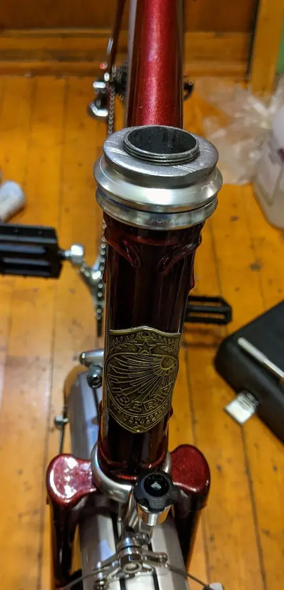

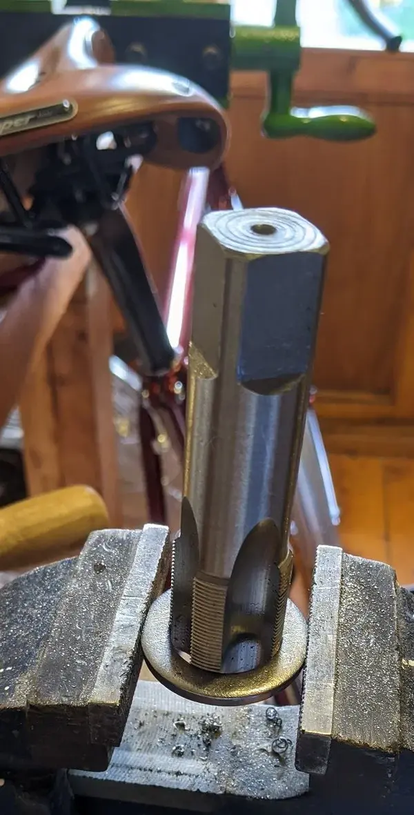

Tapping stailess steel was not as hard as I feared. Some WD40 squirted onto the tap for a good measure and I've done 4 washers. Getting the tap to start straight was a challenge, but only one of the washers was completely messed up, one OK and the other 2 are quite good.
The cheapo Chinese 25x1 tap worked great.
The washers fit well onto the steerer, so I knocked the Tange jobbie out, installed a cane creek threadless (it was a whole 1 mm lower than the neco jobbie and, more importantly, it was silver instead of black!) with the neco split crown race (all fits well).
Just enough steerer sticking out to fit two home-made French nuts, so I've taped the top of the threads and filled the rest of the threaded steerer with epoxy. will put a steel shim over the epoxy and then pre-load the headset with one French nut + lock it all in place with the second nut.
