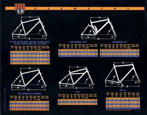

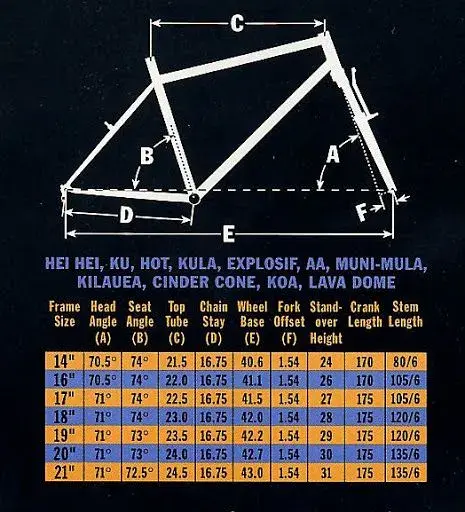

Check out this chart, it is taken from the Kona catalog from 1997. It should give you a better idea of the sizes of their frames.
Wow, that looked a lot clearer when I downloaded it. Perhaps this detail will be of higher quality
