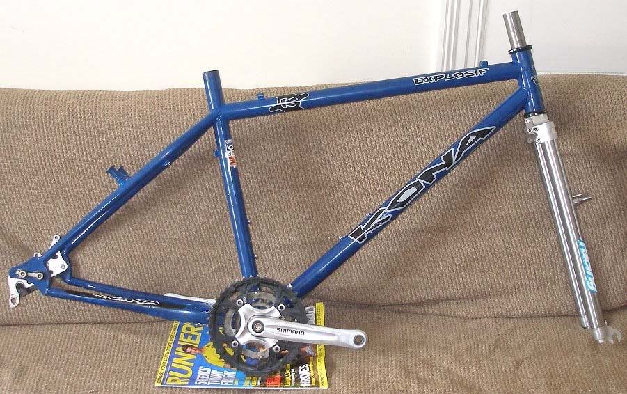

I'm building up a singlespeed commuter bike its going to be parked next to my workbench so it can be a bit nice without fear of being stolen :)
The frame just arrived this minute its pretty tatty but still looks o.k and I was going to put black P2s on it :wink: but these also just arrived :roll: and although P2s seem the obvious choice I do quite like the look of these on it :shock:
Put them on or not ? :?
The chainset isn't staying it was on it when it arrived and before anyone mentions the forks being at a strange angle their just sitting in there loosely for the photo :roll: :D
one-eyed_jim":3neb3r2g said:
Are they long enough?
Not perfect but they'll do for my commuter :wink: they are the slightly longer 420mm crown race to centre of axle ones so their not really really short so I don't think it will feel terrible with them on :)
Ah, I didn't know they'd made a longer model. Mine are only about 385mm axle-to-crown.
I reckon a P2 would suit the bike better, but why not try the Pace since you've got it there? We all know what a P2 looks like in an Explosif, and it's only a 20 minute job to switch.
Looks good to me.
2004 Explosif geometry gave a 71 degree head angle with a 456mm fork less 20mm sag = 436. So a 420mm rigid fork will give a head angle of almost exactly 72. I'd guess that would just hold your attention nicely, rather than give you any problem.

Think thats what I'll do :wink: to be honest I didn't know they made the longer ones either and only bought them as they were cheapish so it was a nice suprise when I measured them up :wink:
Thanks for that Anthony :wink: thats something like I had in my head but its nice to have it confirmed by someone who knows what their talking about :)
And incidentally don't forget that P2s are one cm shorter, so will give a slightly steeper head angle of c72.5.
Unless you go for these, which are 44cm therefore ideal geometry-wise, but for some unaccountable reason some folks don't like them.
