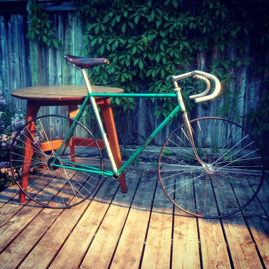

Here's one I'm working on.
1981 W.J. (Jeff) Lindsay:
viewtopic.php?f=23&t=337401
It's a little further along with some new tubular Dugast CX tires and what not. More of a period gravel grinder. It has WTB bars and suntour Barcons. All early 80s.
Jeff Archer sold me the frame :( sad news there.
