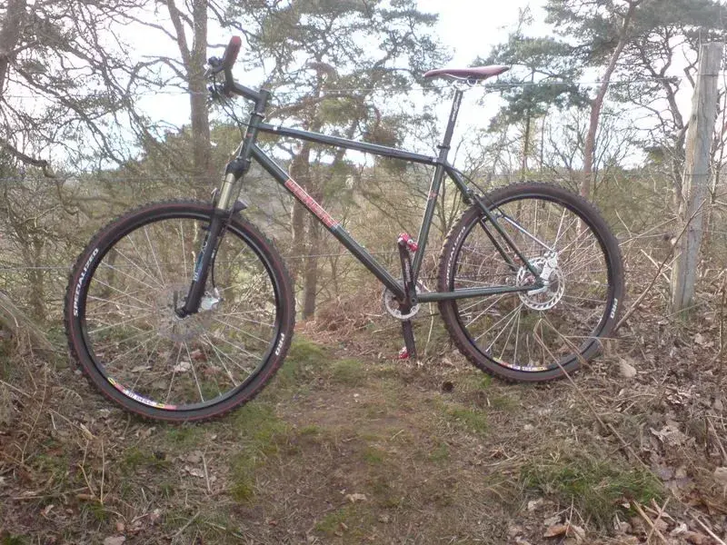

Nothing nasty about this, is there?

Hope C2, no2 caliper.
It's the second set I've bought in the last year. I sold the first and regretted it immediately. These came up for sale, here, a week later.
I have to be honest - that'd look 648 times better with a V on the back. Sleeker, lighter, generally more lovelier. And no chance of shearing the brake boss off.
I've fitted those DDG ones before. You're supposed to drill a hole in the dropout and you have to use that rear skewer (or at least bits of it).
Agreed , V's would look sleeker, but it isn't "nasty". The added control when negotiating roots, rocks and trees, or set up a high speed drift, instantly, in any conditions, is a trade off I'm happy to make.

The nastiness mainly refers to the mechanics of the things, rather than the looks. The Hope is better than most because at least some of the load is taken by the axle. But it's still a wee bit bodgetastical.
It's not making as much difference as you think. You can't apply much braking force to a rear wheel anyway. And if you're using a brake, it's not a drift ;-)
Don't take it personally, it's a lovely-looking bike. I'm just not convinced (having tried the options) that the faff of fitting a rear disc to a bike not already equipped to take one is worth the effort.
