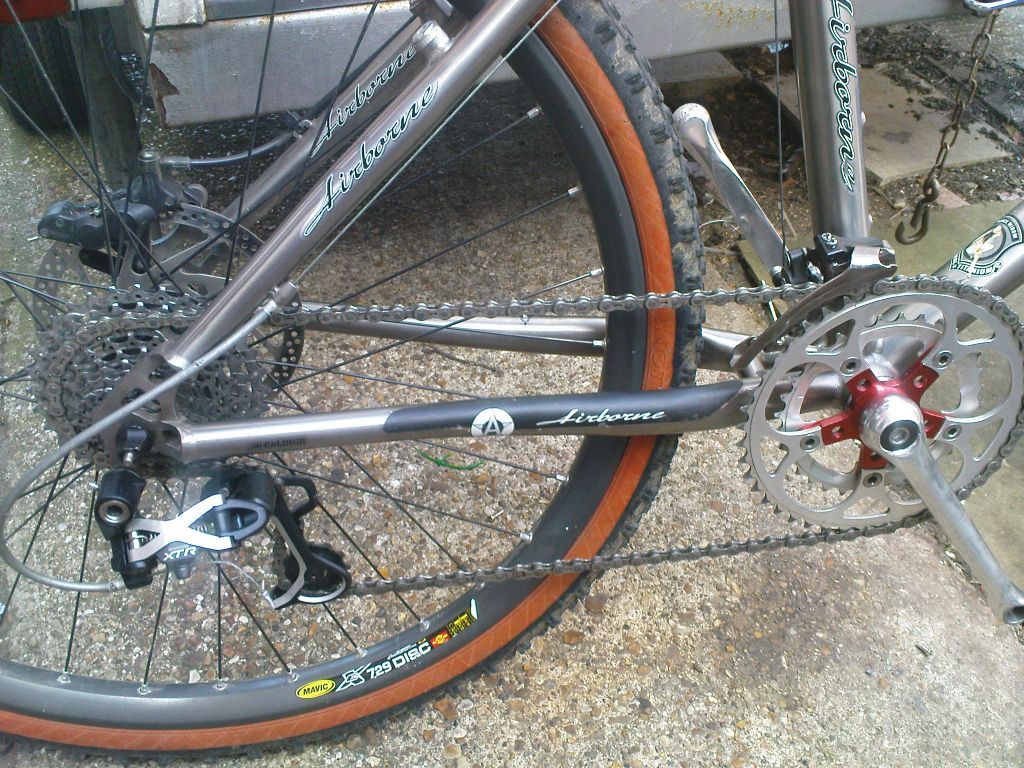

For the normal round style mono mini rotor: (as in the style above on the Airboure)
160mm = HBSP154:160:5
140mm = HBSP154:140:5
