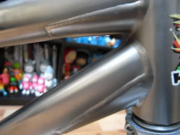

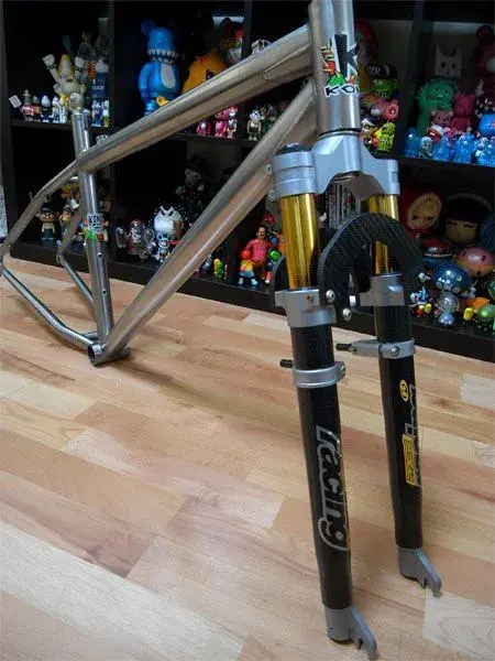

spent 2 hours last night cleaning my new kahuna frame and its looking very lovely indeed. however, some areas of the frame have become more polished that others - mainly the top and downtubes. while it does look very nice and shiny, i wondered if there was a way to get it back to the slightly more brushed finish? at the moment its more like my xizang in places and then brushed/more matt looking in others....
heres some pics, any tips much appreciated!

Very careful rubbing with scotchbrite pad? Or micromesh finishing abrasive. Might take a little experimenting with grits to get the right effect.
You could try a green scourer pad from a super market, or a pencil eraser, the one with grit in it, have heard of people redoing the brushing on watch cases with these.

There is a "non-abrasive" Scotchbrite pad (?the "white" one?) but I think, generally, the medium "green" is the way to go.
The link above suggests rubbing in circles rather than straight lines "along" or "around" the tubing - not sure I agree with that. Anyway, Softly, softly - you don't want to make a big scuffed-looking area on that beautiful KK.
