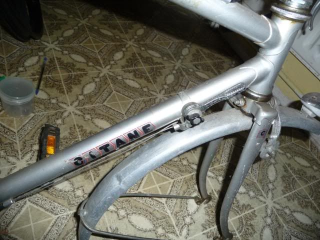

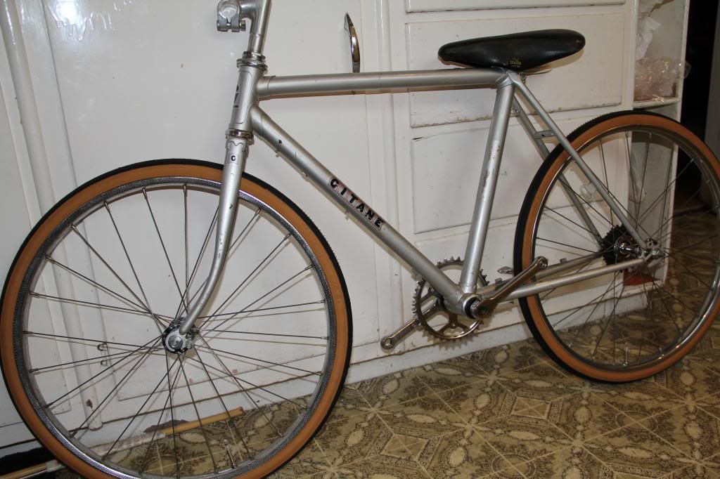

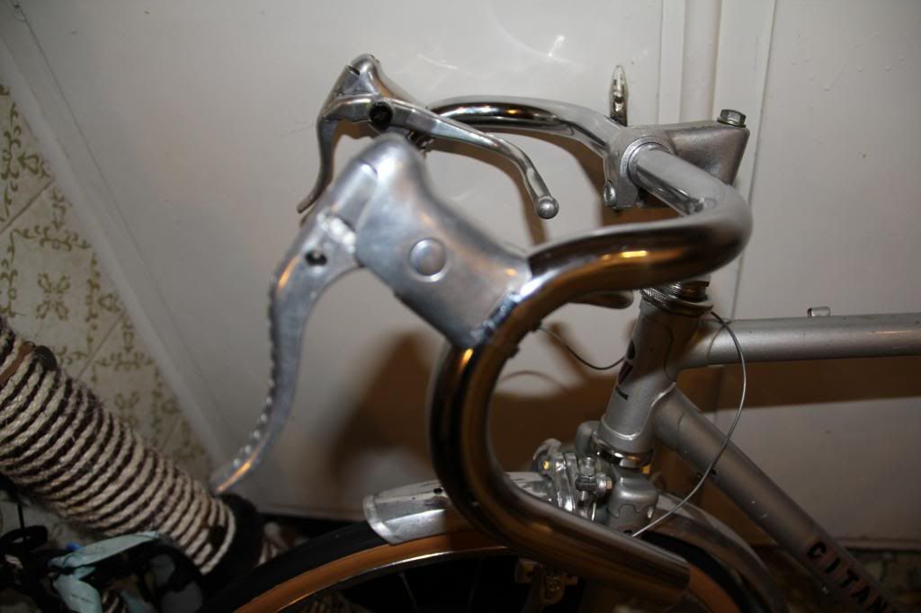

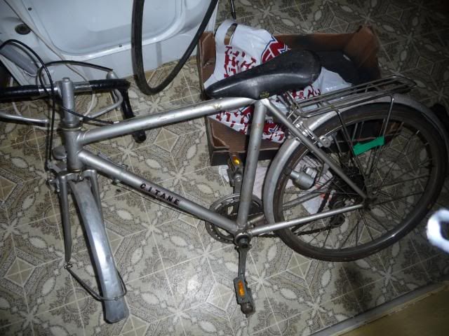

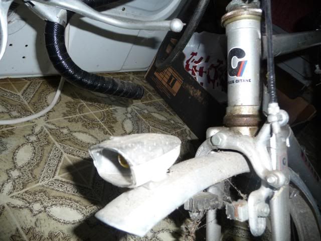

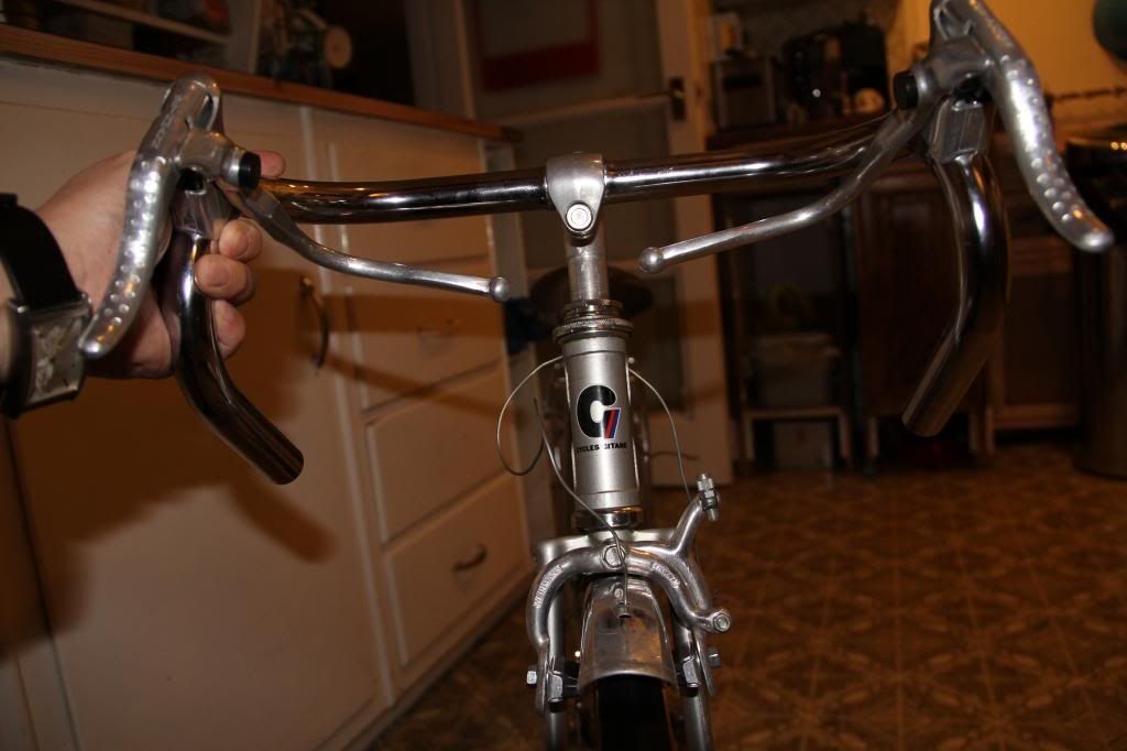

I plan on restoring this for my daughter who is 7 years old she will be riding a 20" wheel Gitane I'm not sure of the model but the closest one I could find was a Grand Prix?

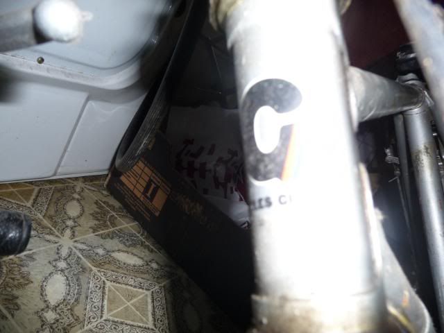

I owned this bike when I was about 9-10 so I found it in my fathers garage and looking sorry for itself.
Any tips would be great, but I'm short of two or three items:

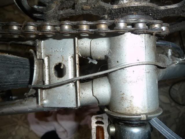

Chain guard three bolt

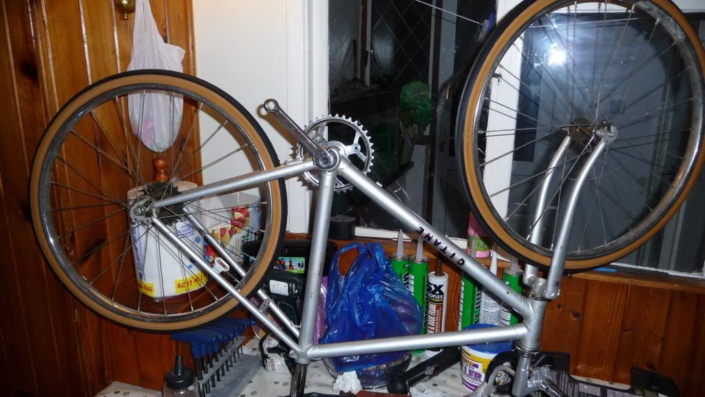

Seriously good start! some good cleaning there as well, you'd never think some of those components were the same ones! nice work
Hello Thanks for the warm welcome people!
Its not been an easy task sourcing parts and the parts bill could have bought a new bike for her, but as this was my bike 34 years ago makes it a little special for her.

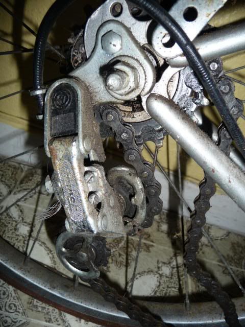

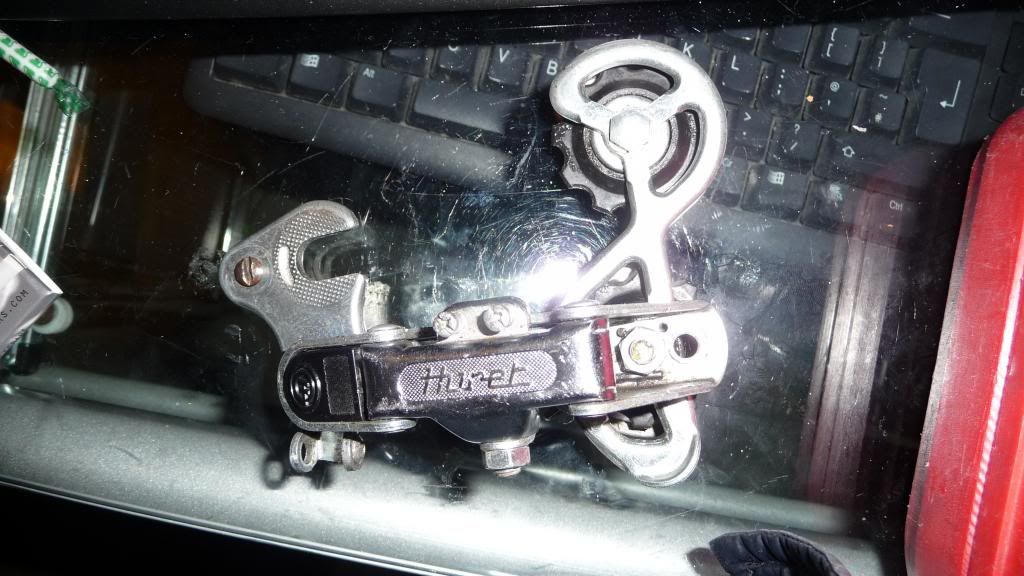

Most of the parts have been dismantled and converted into one usable parts like the derailleur.
The tyres were a nightmare to get hold off 500Ax28

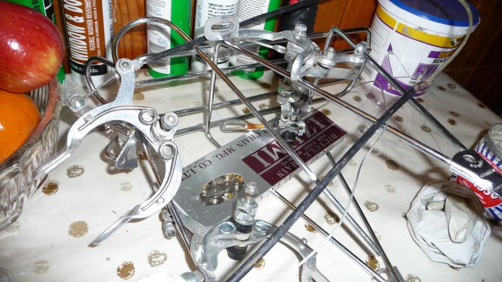

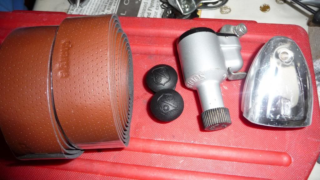

So far parts bought NOS

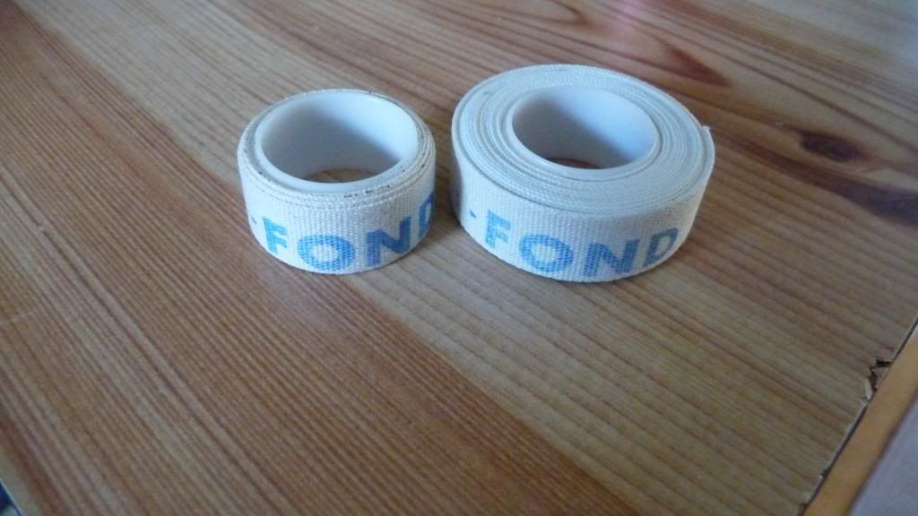

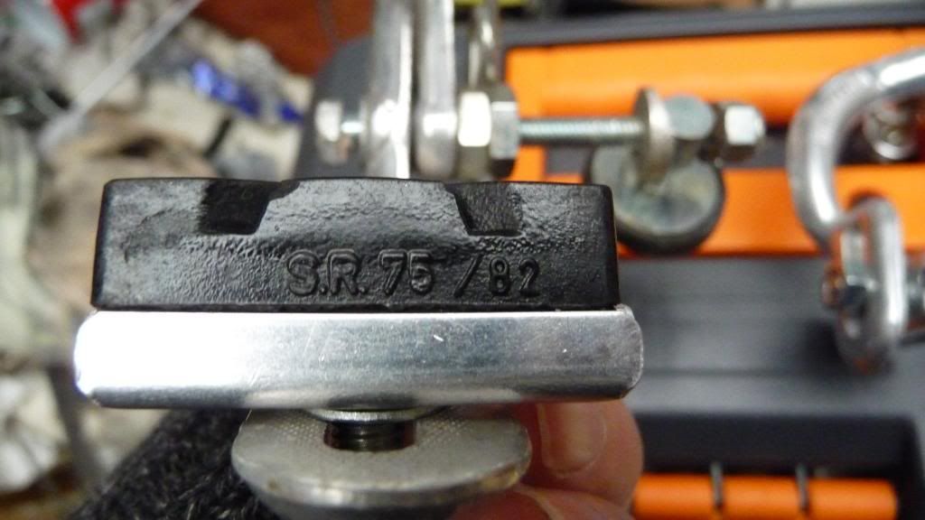

Derailleur, brake/gear cables, brake pads, rear caliper, Pedals, dynamo lights front and back, Rim tape, tyres/inner tubes 28x500A 20", gear cables, handlebar tape, bar ends, FERRULES, Izumi 1/2 chain,

Chain wheel guard

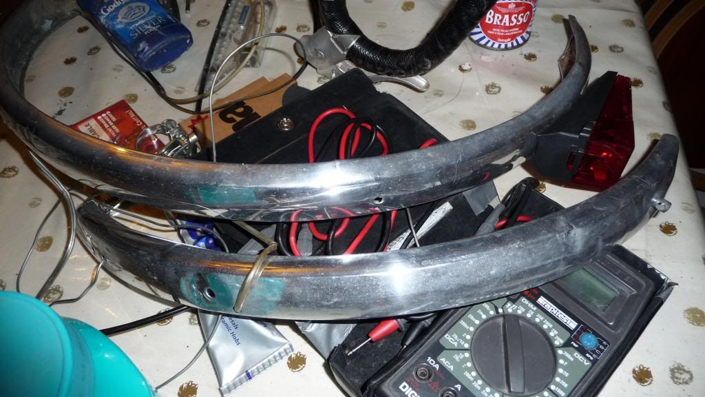

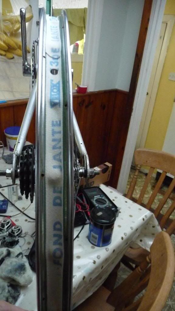

Re-chroming the rims was going to cost me £90 for two and just couldn't justify the extra cost.
A question I bought two inner tubes from Schwalbe with Presta valves and the tube over laps the rim by an inch is this okay?

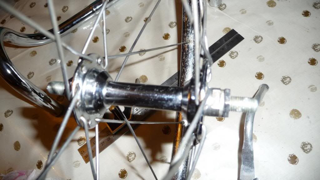

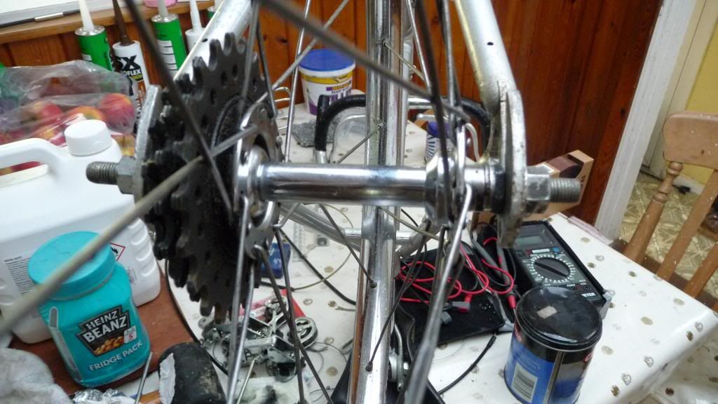

Hi guys I'm missing some mounting nuts for the front wheel its a M6 but I've tried various nuts and the pitch is different does anyone know what other pitch sizes are for the french hub?
