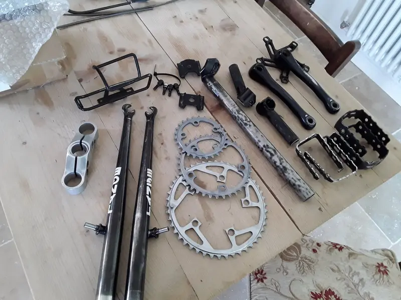

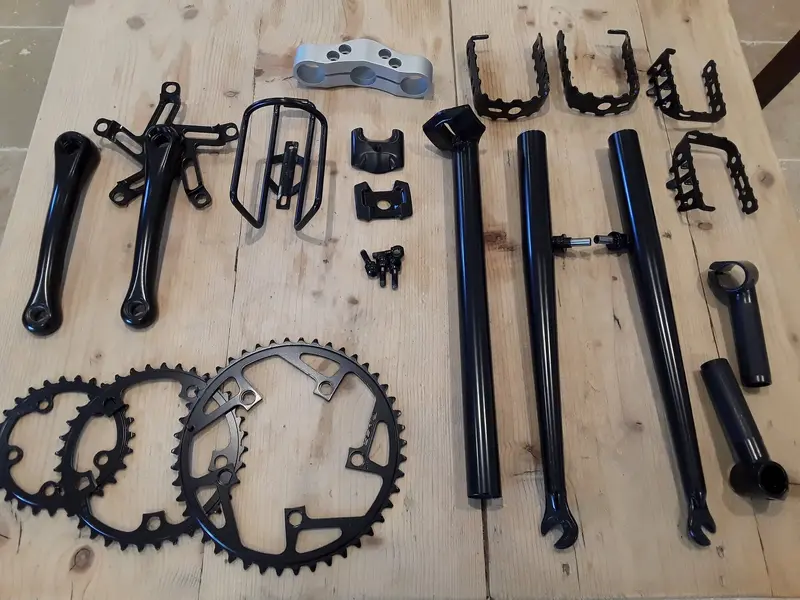

I know ive put these photos on here before some where, but here's a batch before and after.
If your uk based, try mark at High Caliber Coating in suffolk.. Hes a gunsmith, but very good with bike and motorcyle parts......say hi from me!.......and he will probably quote you double!

Wow, those results are very impressive 😲
Cerakote added to the list and High Calibre coating added to my traders file. Thanks!!!

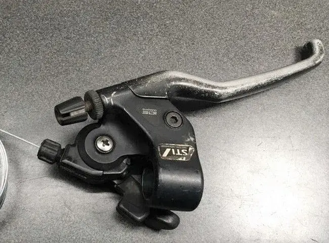

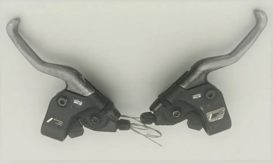

Has someone ever had long-term success restoring old Shimano STIs?
Quite often in particular the brake levers are not black any longer, sometimes entire STI looks worn away.
Still a bit unsure if metal or gun paint will last, especially in case of hand perspiration during use.
