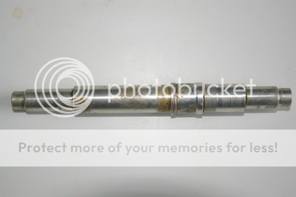

Watch out because if you've got the 'really' old ones; the axle and everything is a different size. I fell foul of this until I contacted the nice guys from Hope. The axle in my ti-glide was a real strange looking thing:
