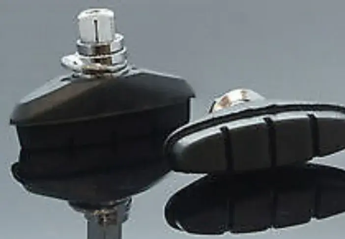

Long time since I rigged up u brakes.
But, save your hardware! Washers n that.
Then get modern blocks and make them fit, older washers essential here as new ones will not fit well against u brake body.
Back soon with images of what I think should work.
Some thing like this.
Do your research on post length etc...

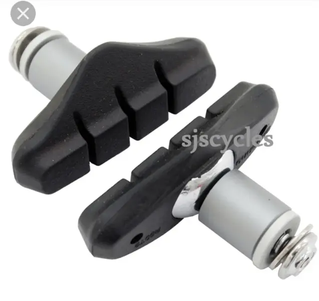

Shimano make a canti pad (cx50, available in your lbs i would hope) with a reasonably similar shape to original, and a long mounting bolt and spacer which could be modified. Screenshot_20240222-114859_Firefox.webp
