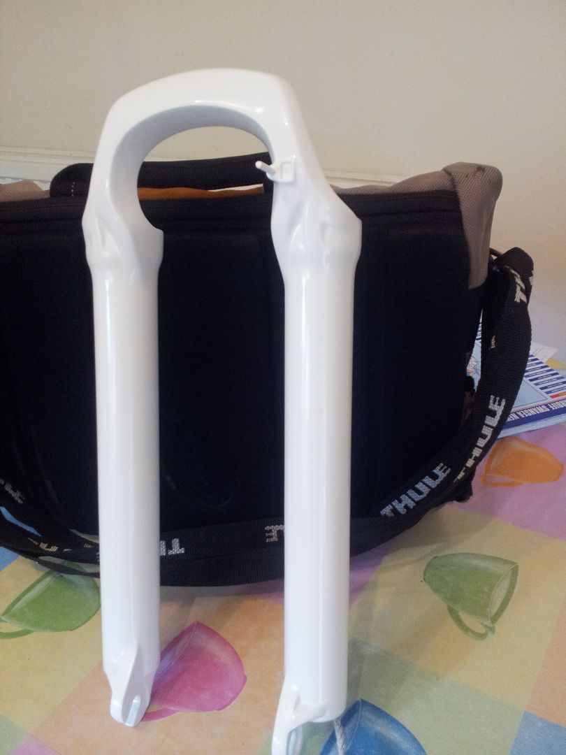

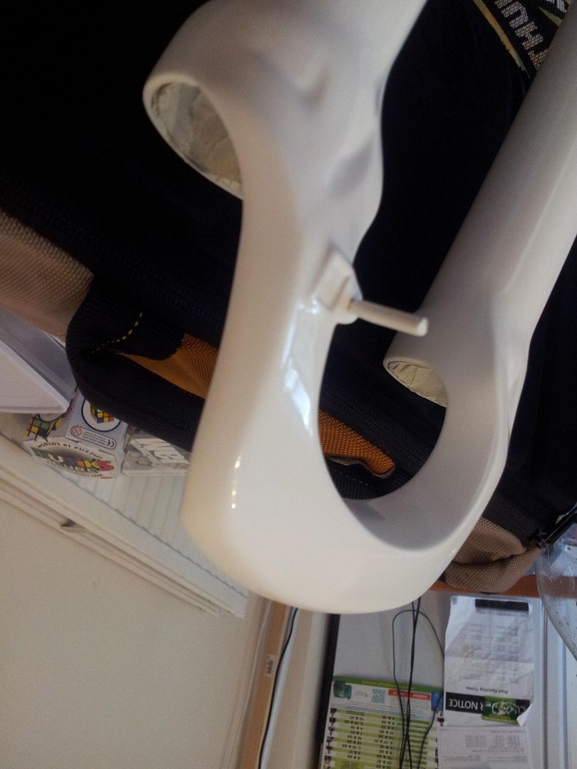

Some more dreadful phone pictures..I will take some good ones when they are finished :wink:
Several layers of white later...bit of rubbing down, some correction to runs (not many) etc. Final spray I held the nozzle closer which I seem to remember gave a glossier finish.
Very fine run with 2500/3000 grit then on with the clear coat!

you using cellulose based paint? you will need to leave them for a little while so the paint hardens.
Re: repainting fork lowers
Simoniz acrylic aerosol. Just finished clear coat and I a pretty happy with the results. Yes, will leave now for a week to cure. Good weather for it

Much top coat applied. Rub down with 3000 then with solvol autosol. Final spray with finish line polish and I have to say...I am rather pleased with the result. New decals to be applied then rebuild. Pictures up soon.
