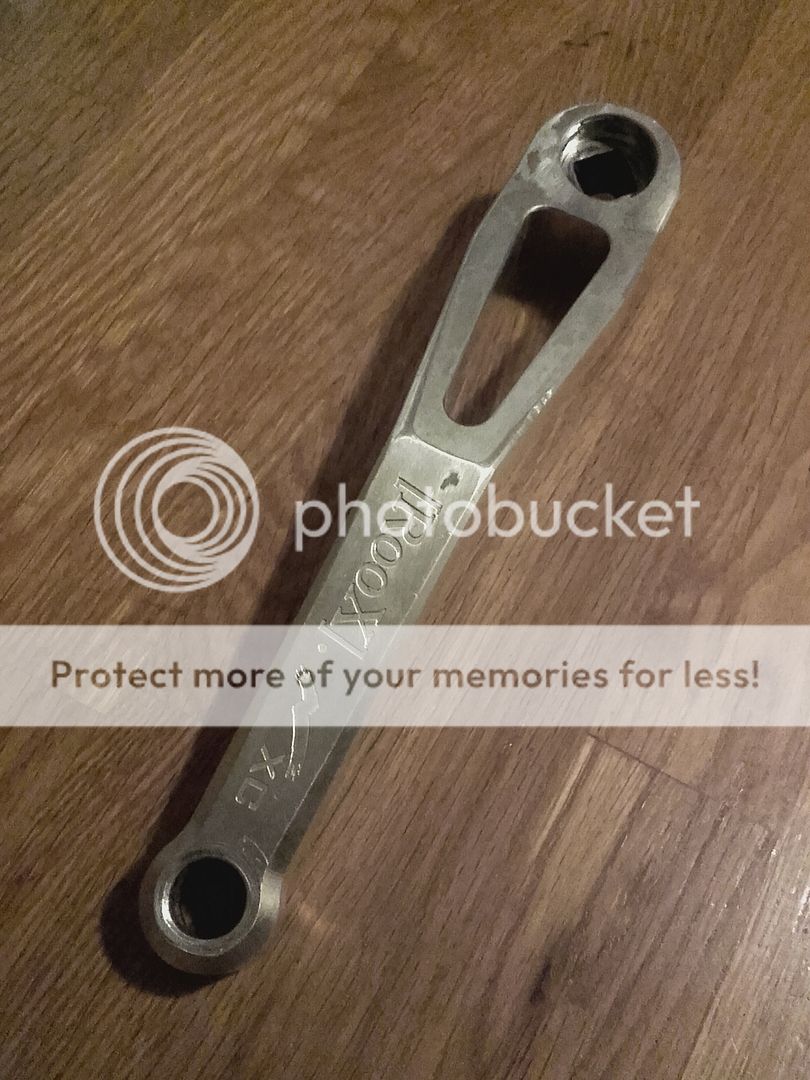

Before:

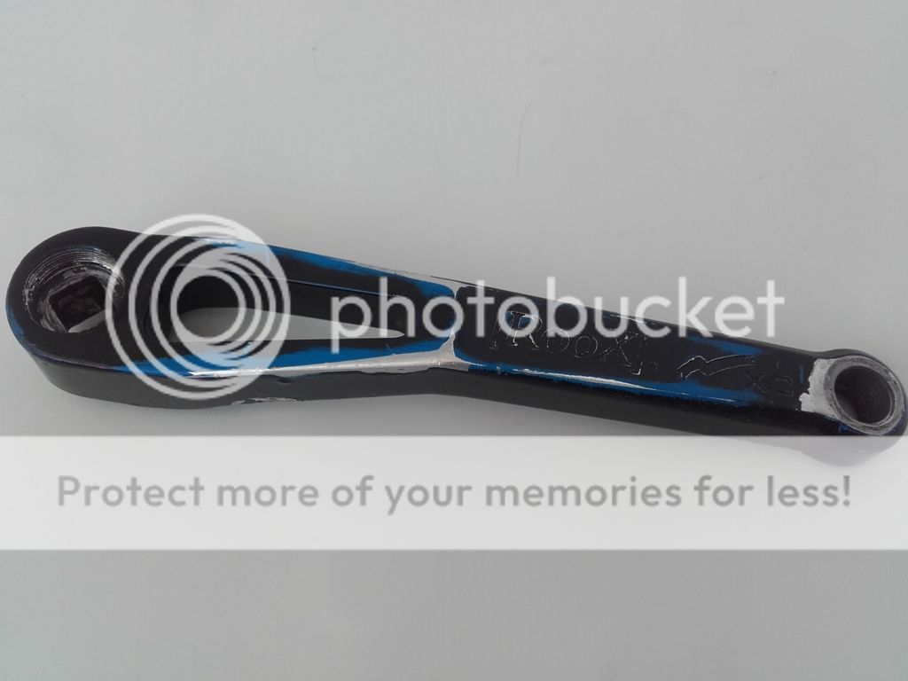

After:
Gasket remover works! It works better when the coat is thinner of course so I might sand the black paint down on the right hand side before I attack it with this stuff.
Looks like that came off nice and cleanly...
Yup, scratching the surface (lightly with 80-120 grit) definitely helps to get the solvents deeper into the paint layers, specially if it's a 2 coat like you cranks.
