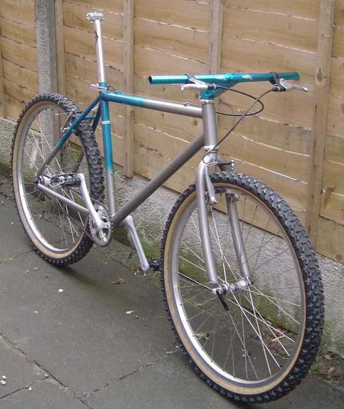

I did mange to remove lacquered decals by warming them with a hair dryer and scraping with a credit card as a scraper. I suppose it would depend on thickness of the laquer.
But be warned it will inevitably leave an unlacquered area which may detract from the finish. (may not be a problem if you're re-lacquering)
I would be tempted to try a un-obtrusive area / decal first.
Pictures below of the bike I built for my brother stripped of its decals. (Headtube, downtube, toptube and seatstays)
