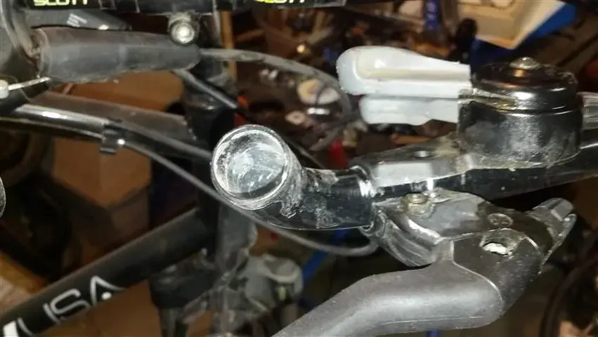

I am in the process of removing LX 7-speed shifters/brake from a Scott AT4 bar. I have pried the brake/shifter clamp quite a bit, but need to go more to get around the last bend near the bridge. Trying not to mare the black Scotts and not crack the LX clamp. Anyone know of any tricks to swing this?

I've gone through the same type of thing. Don't know if this is the way to do it, but it's how I did it.
Used a stack of thin washers (dimes will work too), to separate the clamp, without using more force than necessary, and it keeps it separated, till it slid through, also used a bit of wd-40 to make things slippery.

I just took a hefty flat screwdriver to spread the clamp and simultaneously twisted the brake lever off....scratched the bar a bit but no big deal. obviously, the more you open up the clamp the less scratching.
I've used both of those techniques, above, to good effect. The only thing I'd add is that I 'rotated' the clamp off, rather than trying to pull it straight past the band - if that makes sense?

Using a couple of washers under the screwdriver as I twisted the screwdriver to spread the clamp worked. Just needed a bit more spread. Just felt like I was reaching the shifter clamp point of maximum bend.

exactly, the washers keep the increments small enough to keep from going past the point of no return, and also keep you from torquing on it back and forth, which weakens it. Glad it worked.
