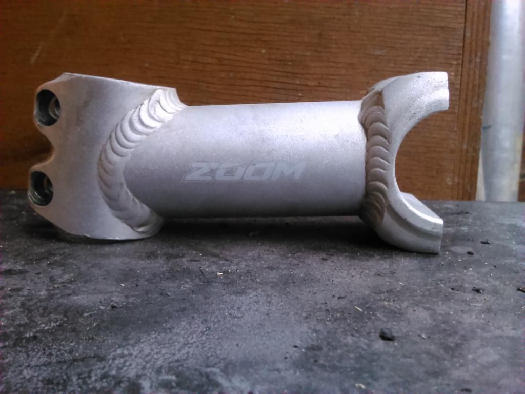

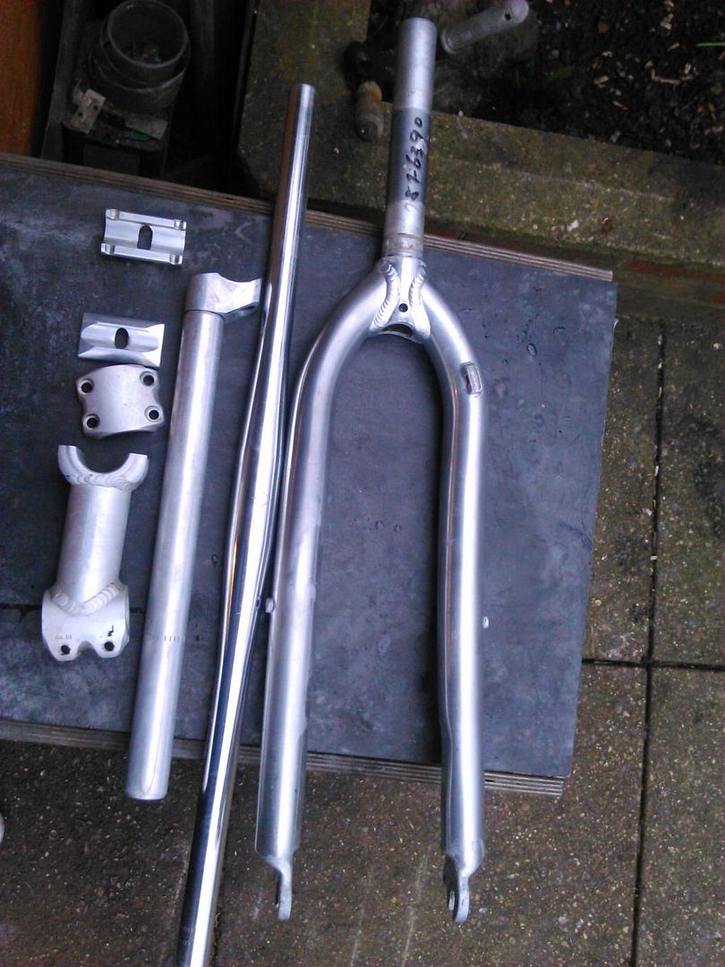

Well i did the anodising stripping today. The results were truely fantastic. Took next to no time at all. That Oven Pride is some good stuff.
I got a bit on the bottom of my forearm when i was reaching into the bucket to scrub it on. Didnt really think anything of it at first, but then i started feeling the burning sensation, and i looked down and the bits of hair on my arm had gone all curly and dodgey. I ripped off the gloves and ran into the bath and rinsed my arm off. A bald patch along with some red dots forming on my skin were revealed :lol: :lol: My skin is totally fine now. Only lasted for 10 minutes or so. Really pissed off with myself though, as i forgot to throw in my seat clamp before i started, and only remembered after i had disposed of all the oven cleaner :x
I used the paint stripper to get the paint off the forks. Worked a treat as the paint was of a poor quality. Ive tried polishing the fork straight away, but its going to need some sandpapering as there are still the normal scratches on the surface from when it was machined. Same with the seatpost, but im going to be keeping sandpapering on that to a bare minimum as i dont want to change the diameter of it. And i never bothered with my stem, as it has a really rough surface.
Another wet sanding session in the cold this weekend it is i then :roll:
