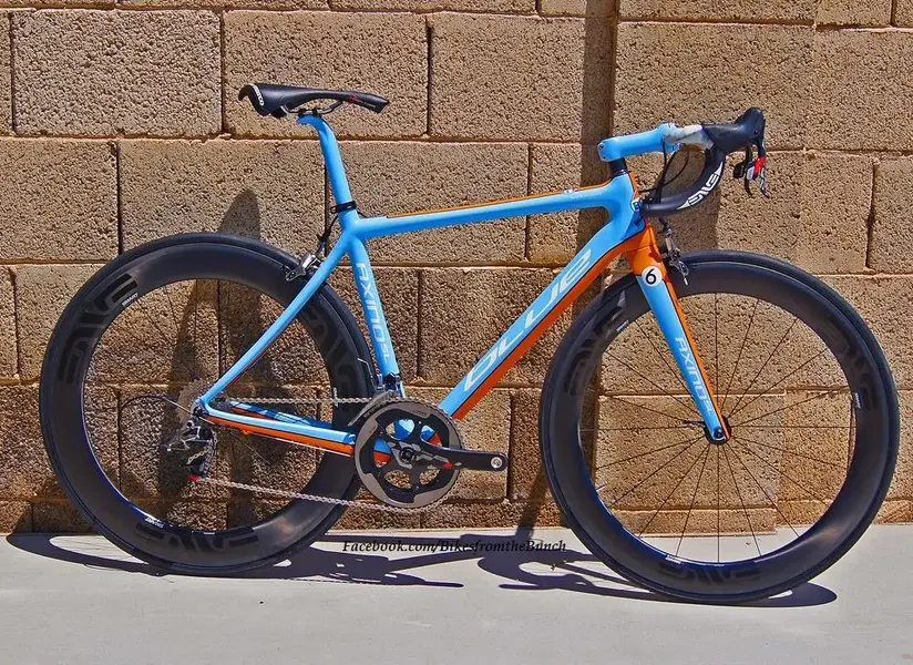

Do I go "original metallic Graphite", or like my rebuilt Superissimo, go with something different? Was thinking a Gulf Mirage/GT40 homage... (I was very taken by this Laverda SF I couldn't afford

It might be tempting to change colour but that Graphite looks really great.
