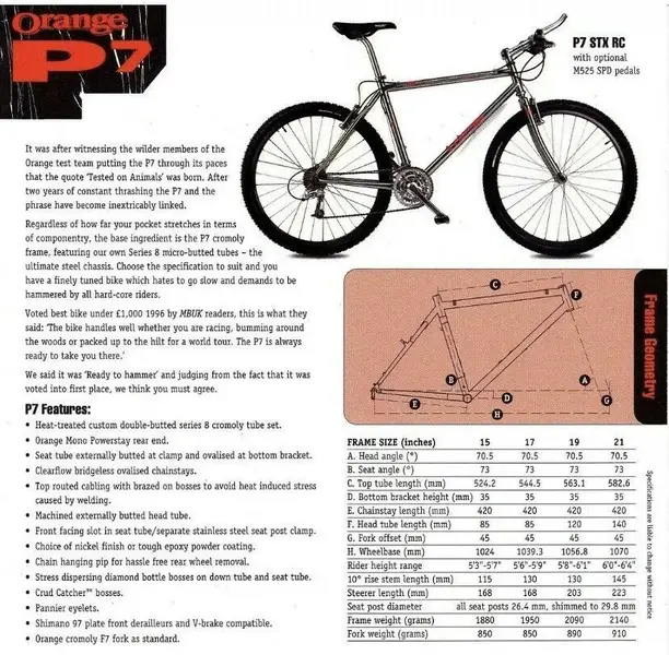

Another question; I see a lot of frames described as 18", but the attached image shows a write up that made me think they only made 15", 17", 19" and 21"?

size....Orange official measurement is from the centre of the BB to the VERY TOP of the seat tube, not the intersection of the tt and seat-tube. So an 'Orange' 17 is actually more like 15.
I am 5' 7" with 31 inside leg, and ride a 17 inch (15ish centre bb to centre tt/st junction) but can easily ride the next size up (I have two of the bigger ones) with a shorter stem. I would size up, if you mean to ride the bike in anger, and use a 110-120 stem. They typically came with 130 stems, but you can raise the front a little with a PACE fork, and shorter the stem, and you then have a great-handling bike.

So with frame size; is it that the official 19" is being measured as 18" by some sellers because they are measuring from the BB to the intersection?
Could be. You can get them to conform. You will soon get used to recognising frame size on the 90's & early 00's just by looking at the head/top/down tube join. Take a look at mine in my signature. All 19" except the 2011 which is the more modern geometry & 17" which I prefer for the standover.
