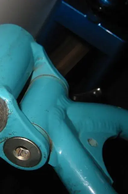

The rear stay pivots have been removed. The clips came off with no problem and are in good shape. The bushings appear to be in good condition. However, I will investigate the "new" bushings as suggested. Maybe these shrink with age and create slop in the rear triangle? Appreciate the input!
The BB pivot "bolt" is another thing. I have removed the 8mm allen bolt on one side (this bolt goes through a alloy "cap" and screws into the opposing "half" of the pivot). On the other side of the pivot there is a larger Allen wrench hole (it appears that this half of the pivot goes all the way through to the other side and is attached via the 8mm allen bolt (removed earlier). Both the "cap" and this "bolt" appear to have been installed with Locktite or are press fit. I am wondering what the best way to get them out will be. If I just put a large allen wrench on it and start trying to break it loose (as if I were trying to unscrew it) it wants to flex the frame mount and it feels really sketchy!! Maybe after supper I will get up the nerve to really reef on it. Perhaps it is supposed to be pressed out?

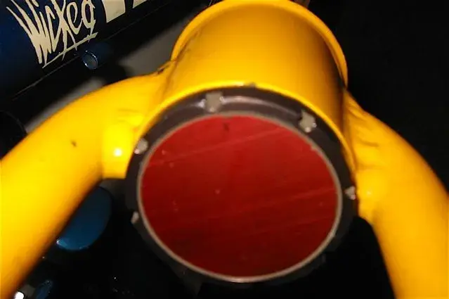

Hole between top tube and head tube allows for removal of pop-rivets. I did the same on my old Funk. It's scary, but do-able.
