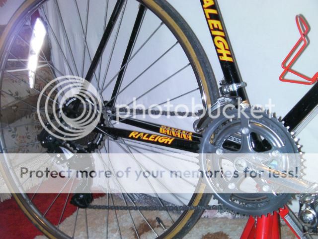

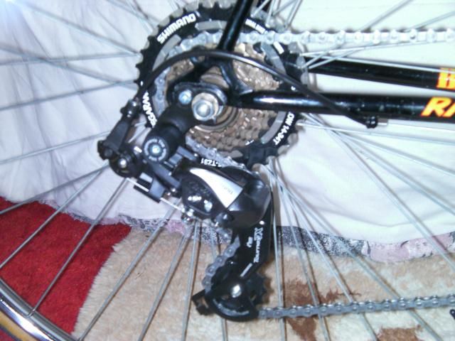

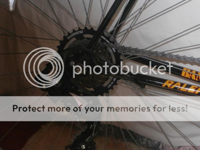

Heres my new Gears
Well picked my Raleigh Banana bike up
and the 14 Gears ,new chain and shumano Der had been fitted and i dont think it looks too bad they work very well smooth changes and i can peddle with ease which is more than i could do ,the old girl is quicker than i exspected and a beautiful ride ,the cost was £56 and i think it was money well spent as i am really pleased ,has it got to be the brakes next ?i know i could do with some puncture proof tires ,but for now the weekend is upon us and its off to the Harecastle tunnel and Bathpool for me over the weekend ,i would like to thank everyone for there help because i could not have done the brilliant upgrade without you ,
just another question ,where does the 14 gears come from as there are only 7 fitted to the rear and two upfront lol very best wishes Brian.
It's a bit hunky chunky in comparison to what was on it, not what I would have chosen personally but the main thing is you're happy and it doesn't look too bad, colour coordinates well.
I see what they have done is fitted a regular freewheel with an extra large large cog giving, in effect, a granny gear. I think that's a shimano mega range freewheel.
Bet it's nice and tight/smooth now with the new drive train. Always a good way to improve a ride. Invest in a track pump and keep your tyres pumped up nice and hard too.
Not sure if the where's the 14 gears come from question was serious but basically if you're on the small ring at the front you have the seven gears on the back, then when you're on the large ring you have another seven gears; 14 in total.
:facepalm: Hey, as long as your are happy with it is what counts, and you have a nice clean gear shift.

Sorry to wheel out the pedantry, but for me calling this 14 speed is a bit misleading. You should avoid crossing the chain over by riding in the big chainring-big sprocket or small ring-small sprocket combinations.
It's something people new to cycling often do, but it wears the chain more quickly, and could potentially lead to breaking the chain.
Since it's probably not advisable to use the two big-big and small-small
combinations, it would be more accurate to call a bike like this a 10 speed really.
Like I say, sorry for the pedantry, but most people new to road cycling with
double rings (me included) make the mistake of crossing the chain over, but it's not a very good habit.
