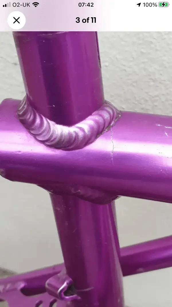

Really really stupid question 🙃
As daft as it my sound, these issues are rarely tested to destruction. Once discovered, they are retired. It may have been a daily rider for the last keeper, that crack wouldnt have happened hung on a wall.
I guess that its your call, but doing something about it is still an option.
Are you trying to avoid pricey re-anodising? A decent alu fabrication shop will buzz a weld over that quite easily.
The problem with alluminium is, unlike steel, there is limited warning of catastrophic failure! Steel will get worse and one day break.....alluminium is likely to go bang just as your sphericals are in that region of the frame.
