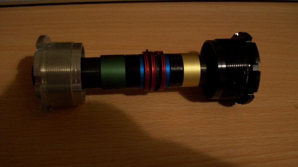

Has anyone Fitted up a Real crankcase b/b :?: i just bought a nos unit for a build but it has no fitting instructions.
loads of wee shims and stuff, looks a nightmare!
anybody got any ideas how its fits up :?:

Shame there's no instructions. You put the spacers in either side to make up the bb width. You can also swap them about to alter chain line.
It will be trial and error without the sheet to tell you what goes where.
The wavey spring washer goes in the middle. :D
Be careful putting the cups in as they are quite soft.
Might be worth asking someone to do you a scan as its going to be a bit of a mare otherwise.
Looking at the box cover i reckon she goes a bit like this :?
was sorta thinking you loose the blue spacers for a 68mm shell and add in for 73mm :P
Looks about right to me. The table in the instructions deals with different spacings for triples and doubles. I sold my BB in a bike but the instructions might still be down the shed. If I can find them you are welcome to them.
I have one of these on my singlespeed. I didn't get the instructions in the box either (apparently they were commonly left out) but I do have a copy (in electronic form I believe) somewhere. I'll find it and get it to you.
These are the biggest PITA BB ever to fit. Much faff.
IIRC, the spacers are 'summetrical round the centre circlip (the imaginary centreline), with the gold or the grren being the swapots between a 73/68mm bb shell?? Remember, its symmetrical aboutthe centreline, so the 73mm is only 2.5mm "wider per side". chainline adjustment is made up with the red ones. Slack is "accomodated by the wave washer.
ACCEPT, that the design is poor, so it'll creak.
and that you'll likely wreck the bearings if you tap it in and out too much, as thy're *tight* on the axle.
