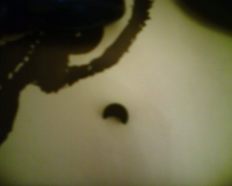

The ones Jerky sold me had the inserts and they work very well with the Avid Ultimates on my Lloyd - not quite as good as the XTR levers they replaced but certainly well enough to remain on there (and look awesome) 8)
A couple of very poor quality pictures that Jerky sent me :? Sorry to post these on dude!
It will be easy enough to file something up to hold the block in the upper position - no doubt I will have to do that when I lose the plastic moon things :roll:
