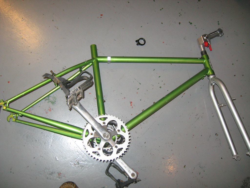

Here we go. None of the parts/paint are original. What do you think?

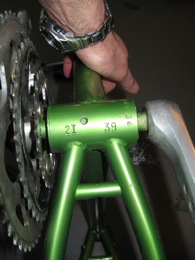

You'll want that serial number long one, I cannot see the start. Also a picture of the bottom of the seattube just above that bottom bracket to get it's shape.
The drop outs suggest an early frame 92ish or older and there weren't that many frames in the line up then so that should narrow things down.
Sorry, thought I had loaded that photo. I know it`s from the early 90`s...not an Explosif or Kilauea. The question is more of which model down from there that it is. I worked in a shop selling Kona from 91 to 94, there`s a chance I even originally sold this bike! :LOL: There is a 93 in the number...is it that straight forward for the date?
F2.... I believe means the frame was made in 1992, so places it as 1992 or 1993 model
I'd say its 1993 as the 'fender mount?' on the seatstay is not sat on the tube, but pierced into the tube

If it feels damnd heavy in the 6lb region it's a Hahana/Fire Mountain
I'f it feels about 5 to 5.5lb it's Lava Dome/CinderCone.
Not sure if an ovalised seatube near the bottom bracket tells you anything between these two frame groups ?

I'm leaning towards a 93 model made in the later part of 92 as well, and agree the only way you're going to be able to get any real indication is the frame weight, unless you know a few people with similar aged frames to be able compare the serial number to.
Unless the model really bothers you you could just sticker it as a Kona and leave it model less. Just a thought... :cool:
