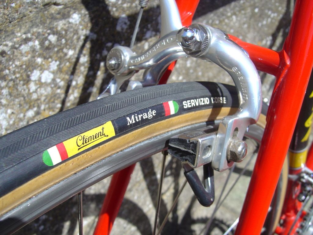

Morning all. I did try some car tyre weld but that didn't work (although it was stuff I found in my garage and at least 10 years old :roll: )
I went for a ride yesterday and now the front tyre leaks a bit. I'm admitting defeat and looking out for some other clements on ebay. I will still just out of interest contact the repairer guy in the comic. I want to be able to ride it without worrying about a puncture or blowout every ride!

Best idea. You still have the original tyres only now you are not risking breaking your neck with them. Not to mention the damage to the bike that a blown out tub can cause.

Well I gave up in the end, luckily some nice period (ish) replacements came up courtesy of a lovely old man in San Diego :lol:
I will keep the originals though, juuuuust in case........... :lol:
