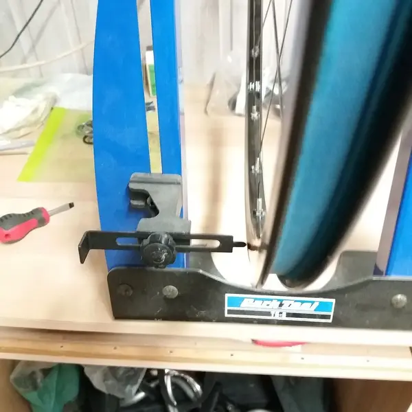

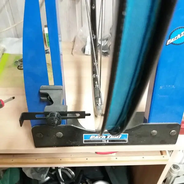

The first couple show the extent of the offset, with the wheel just flipped around in the jig. It's about 5mm total, so needs to be shifted away from the drive side by about 2.5mm.

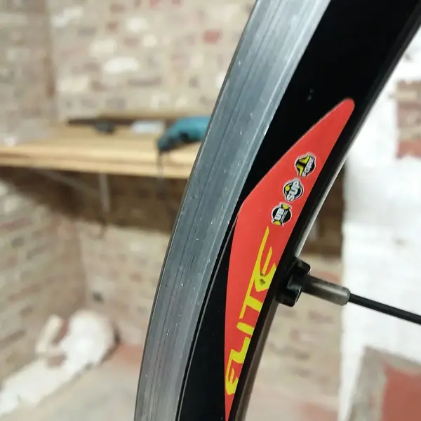

I've also added a pic of the rim decals in case anyone can identify the model. If there's a way to shunt the whole wheel over then that would be great. If not then I'll re-dish it.

I have some of these too. I guess a simple re-dish using a spoke key.
I run mine without rim tapes though - you seem to have a blue rim tape ??
I'd guess some are drilled straight through (the only elites i've played with are, but they are 10-12 years old, at least.) Others (later ones) might not need to be. Saying that, the Fore inserts suggest this isn't drilled through, so maybe the tape is just there to stop things dragging round the rim?
Anyway these are using the Mavic Fore inserts, so should just be a matter of redishing with a normal spoke key, as it looks like 2mm bladed steel spokes. Just be careful of max spoke tension in case the insert pulls through, or the nipple binding up on the insert and unscrewing it!
Think they also have a nyloc feature. (think the nipple is called an ABS Nipple, but not sure)
also I have a plastic tool to hold the spoke which makes sure it doesn't twist as you work the spoke key so that the bladed spokes don't end up facing the wrong way, but you don't need this tool, just something slotted will do.
I just pushed a few sections of the rim tape to one side and the rim bed isn't drilled all the way though. So it's strange that the tape is there.
The wheels are as they were when I received them - I guess the previous owner put the blue cloth rim tape there. Old habits die hard I guess!
