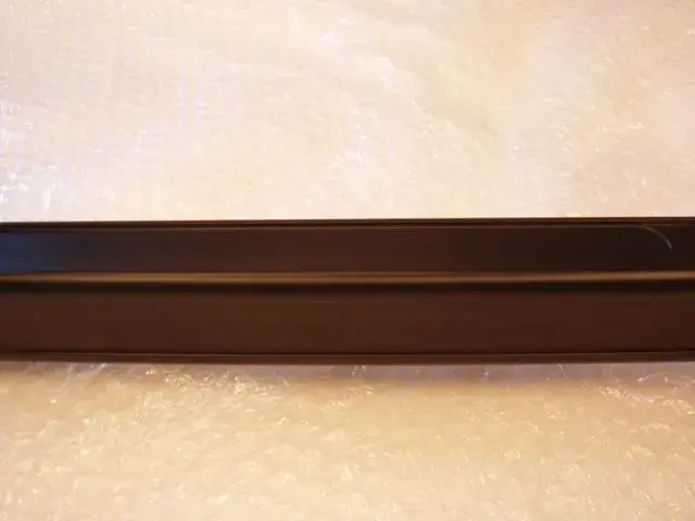

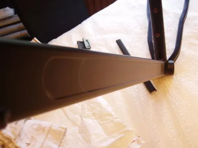

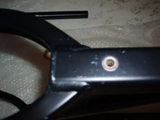

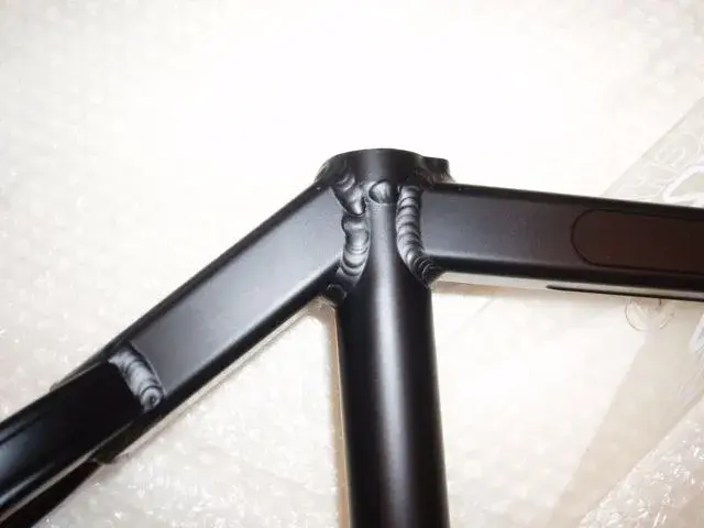

Frame came back yesterday, and it's an amazing job.
I had it dipped, bead blasted and re-anodised satin black. It looks like it was made that way - a very professional job. Obviously, the bits that were 'a bit rough' going in have come out looking less than smooth but that met my expectations.
Attached shows the finish I got and the top of the rear triangle which was a bit pitted.
The frame needs to be stripped COMPLETELY including bottle cage bosses as the steel conducts electricity better than the AL frame and the current melts them.
CCA had my frame for two months, but the work was £80 - and they did my seat pin collar gold too!
All told, I'm well chuffed.
Now I can put her back together (some retro parts and some new) and will post photos as soon as she's being ridden.
