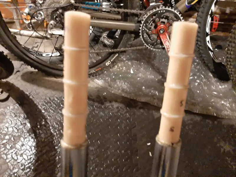

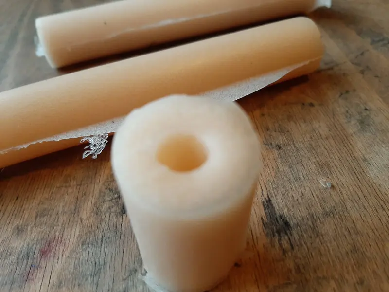

Update: final compound tested. Running with 4 MCUs per leg and trimmed top out elastomer to 8mm is achieving 48mm travel with medium MCUs. Using half medium/hard was achieving around 40mm. Just trialling the first coloured sets this week (hard-red, medium-yellow and soft-green....very original!). I think we're nearly good to go! Do any of you use RC35s on a commuter as I'd like the first set to go to someone who is giving their 35s a good regular hammer to trial them? Should be able to make them in the later 16mm/5mm MXC type...just sorting out the tooling
BTW MCU now rather than monolithic elastomer
