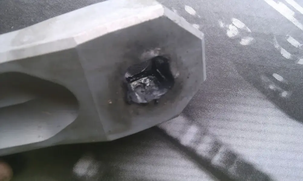

Acor non-drive cranks completely shot! Square taper a complete mess (see pic). I guess whoever owned it before had no idea that it was loosening and just kept riding. Drive side seems alright.

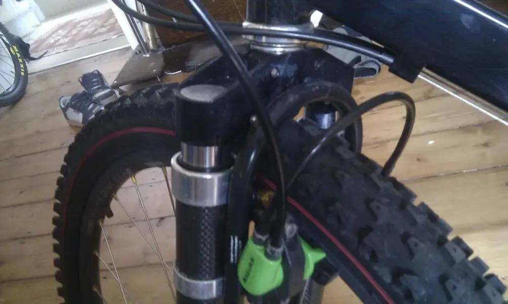

Forks are completely bottomed out. I've never been inside an RC35, but I'm assuming the elastomer configuration must be all over the place, unless it's missing them altogether. Alternatively I'm just being a bit thick (RC100s are a bit before my time).

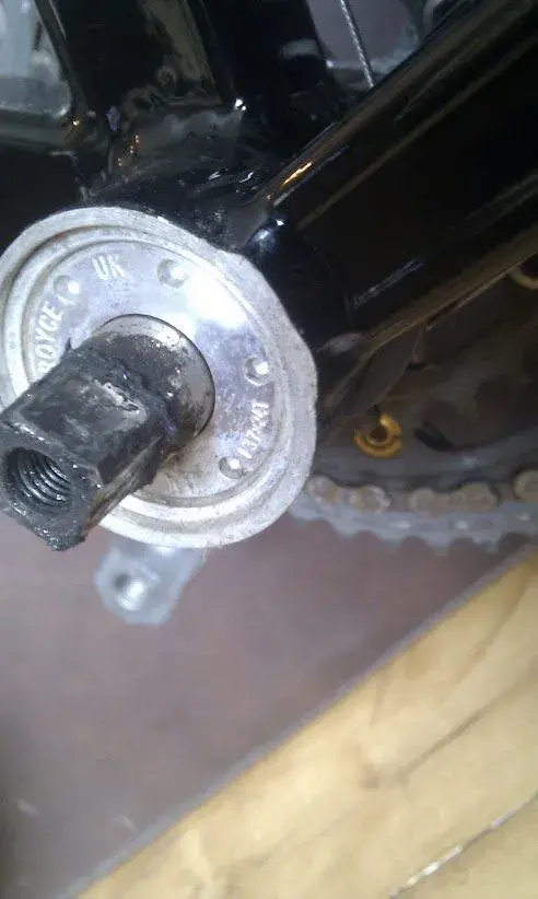

Have a look at photos of the BB set up, doesn't actually feel too bad, but not very convincing. Again I have no knowledge of press fit BB cups, so don't really know what's going on here. I'm sure there are plenty of you on here that can enlighten me?

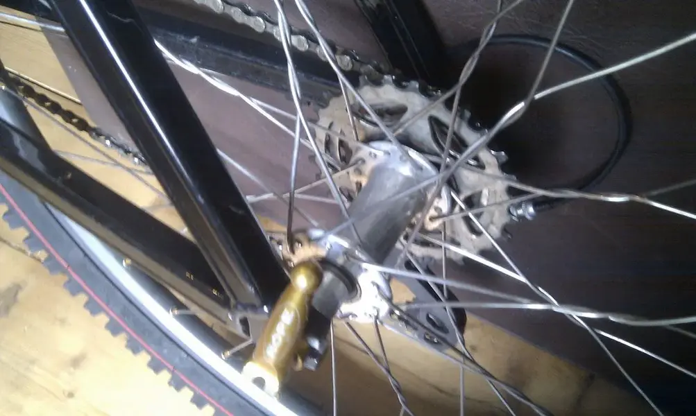

Can anyone confirm what the rear hub is, I wasn't aware that pace made them in silver (seems almost unbranded)?

the rear hub is a BullsEye one.
Doesn't look like one to me - missing the flanges. Looks more like an American Classic or Kingsbury
The bottom bracket shell has been narrowed quite a bit judging by the facing going back to the welds.
I remember a black R100 on Ebay about 3 years ago with a modified BB, running taper cranks.
Rear hub definitely a Pace threaded rear hub, they used to have the earlier "serif" style decals in Black but they always peeled off very easily
RC100 BB shells are 95mm in width, to skim this down to 68mm and then cut BB threads will have taken the crank arms very close to the chain stays unless the BB spindle is very long...

Fork elastomers will have broken down I would guess, case of undoing the long Allen bolts at the bottom of each leg and sliding them off, would guess you will find a load of perished bits

That BB shell does look to have been skimmed down... look where it's bit into the weld!

Nah, not Steve Worland's Pace, think RC300 may have that still? Cliff Ponting at Royce would be able to advise you about the bottom bracket, possible that the shell has been threaded to accept the Royce bb?
As advised, remove the outer carbon legs via the Allen bolts at the bottom of the legs and slide them off, you'll probably come across some elastomer butter!!
