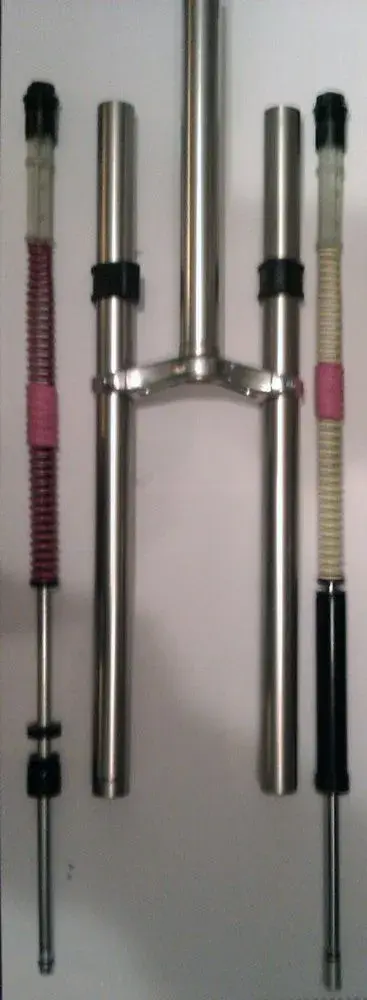

I'd be interested to see any pictures of the insides of other Judy XL's, as I am fairly ignorant of what they are supposed to look like
many thanks for the picture LTS Biker. Your internals do look slightly different to the ones in my fork. I have plain springs in my forks, whereas yours seem to have a short sleeve around the outside of the spring coil. Could this be why I get a rattle, as the spring flexs and contacts the bore of the fork leg? In addition, your fork has a white (plastic?) extender piece between the spring and the pre-load adjuster. In either leg of my fork, I have a short piece of aluminium tubing capped by two of the plastic spacer discs (similar to the one that sits on top of the cartridge). I guess my spacer arrangement could cause the rattle, if the spacer length is wrong.

the rubber around the spring is indeed against rattling against the inners.
It's a rubber sleeve you put around it and it shrinks when heated. You can get it at hardware stores or electronic stores.
They are meant to be used to seal electronic cables, but larger ones be be used as protection against rattling :)
Be aware, I tried this with other springs, and after that, they didn't fit in the inners anymore.
sounds like the heat shrink might be worth a go - I guess you can always take it off again if the spring is a bit snug
