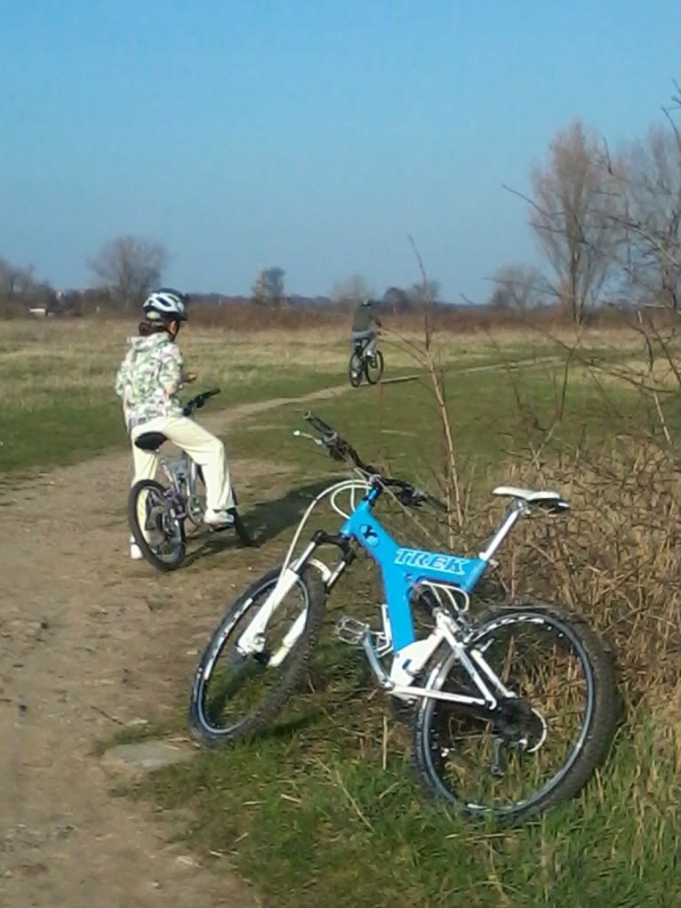

Thx for all the come backs guys very interesting, no-one has recommended nitromorse!!! I have had 2 bike powder coated before £50 each as per photos attached. it was just this bike is a mess with a nice dent in the top tube. I was just going to fix it up & didn't really want to spend too much on it (see last picture its a Marin Bear Valley 1988 I believe)......
