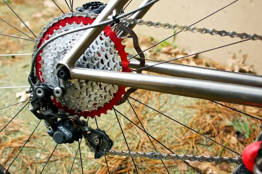

You might look at the ZEE. There are 2 versions. The DH has the SS cage for 28t cassette. The FReeride is GS for 36t. But at MTBR there is a bike with the 28t cage on a 42t cassette. Chain length is critical. The only explanation I've heard is thht for full suspension DH bikes Shimano builds in a lot of extra derailleur capacity for chain growth due to suspension travel. Also modern SS is looking a lot like older GS, and newr GS is almost as long as older SGS. I have a Zee DH on the way. This may end up on the XC bike. I have a theory that Shimano 11s is the same cable ratio as the SRAM 1:1 stuff. So I'll try a vintage SRAM 8 speed 1/2 pipe twist shifter with modern 11s Shimano Zee derailleur. I'm at 40t cog on both bikes. For the 11s bike the SRAM NX Gripshift is working fine with Shimano already. I may stick with gripshifter but switch from Rapid Rise to my own front freewheel mods to shift with or w/o pedaling any time the bike is moving. Full range up or down.

I've got the Zee in hand, and it is compact. The cage is shorter than my XTR GS.

Zee M640 SS DH 270g Metal clutch lever for hard use.

The SS caged Zee can go on the 40t cassette, but the geometry is way off for the smaller cogs. The Freeride GS version is probably better. I might put the SS cage on one of those and see how that goes. I do like short cages on 26" urban bikes. But with Front freewheel you can pull them all up next to the frame as needed.

The problem with the Zee is that I got the DH version thinking that it was the SS size, and the FR version was the GS cage. But they're both SS sized. The solution turns out to be that the SLX which is on the bike now has the same part# hanger extension as the FR Zee. This solves the problem.
