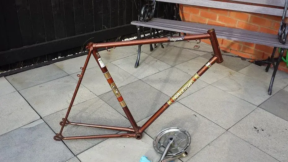

Bruce,
thank you, this is a great help
All,
Thank you this is a great help, I am now looking for a “donor” bike. Anyone got any ideas?
Attached is all I have, so will be an interesting first project
paul

That is a lucky find.
Is that bike the same size as your frame?
The picture is a bit small, but that headtube looks quite short. In which case the front fork won't fit your existing frame because the steerer tube will be too short. Otherwise that bike looks to have most of what you need.
Looking forward to further reports.
Bruce

bruce,
Great find! Frame is a lot smaller but your right I can use brakes ect picked up a later model set of front forks for £5 so I am reusing the head set and drops.
bikes just been sand blasted so now looking for a local company to spray
paul
